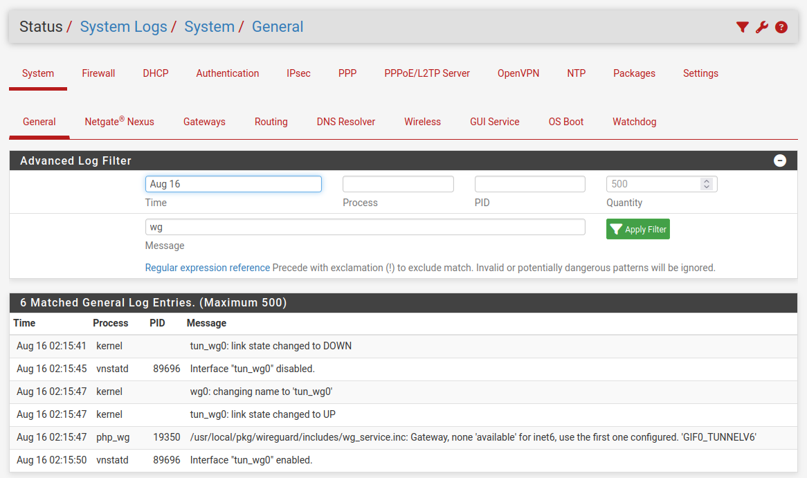

                                  Yes you won't see anything in the pkg_log, that only covers the pkg install, but I'd expect to see something logged in the main log. For example when I restart it I see in the main log:
                                  Aug 16 02:15:46 	php-fpm 	77985 	/status_services.php: The command '/usr/local/etc/rc.d/wireguardd stop' returned exit code '1', the output was ''
                                  Aug 16 02:15:47 	kernel 		wg0: changing name to 'tun_wg0'
                                  Aug 16 02:15:47 	kernel 		tun_wg0: link state changed to UP
                                  Aug 16 02:15:47 	php_wg 	19350 	/usr/local/pkg/wireguard/includes/wg_service.inc: Gateway, none 'available' for inet6, use the first one configured. 'GIF0_TUNNELV6'
                                  If any of those things failed with an error I'd expect to see that there too.
