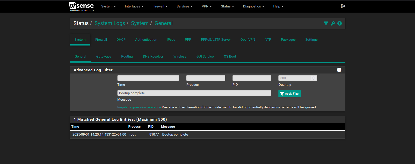

              Bootup Complete should appear in the main system log like:

                • stephenw10S Online
                  OK so the file is not present which indicates it has completed boot.
                  Do you see the 'bootup complete' line in the system logs?
                  B 3 Replies Last reply Reply Quote 0
                  • B Offline
                    Buffalo0207 @stephenw10
