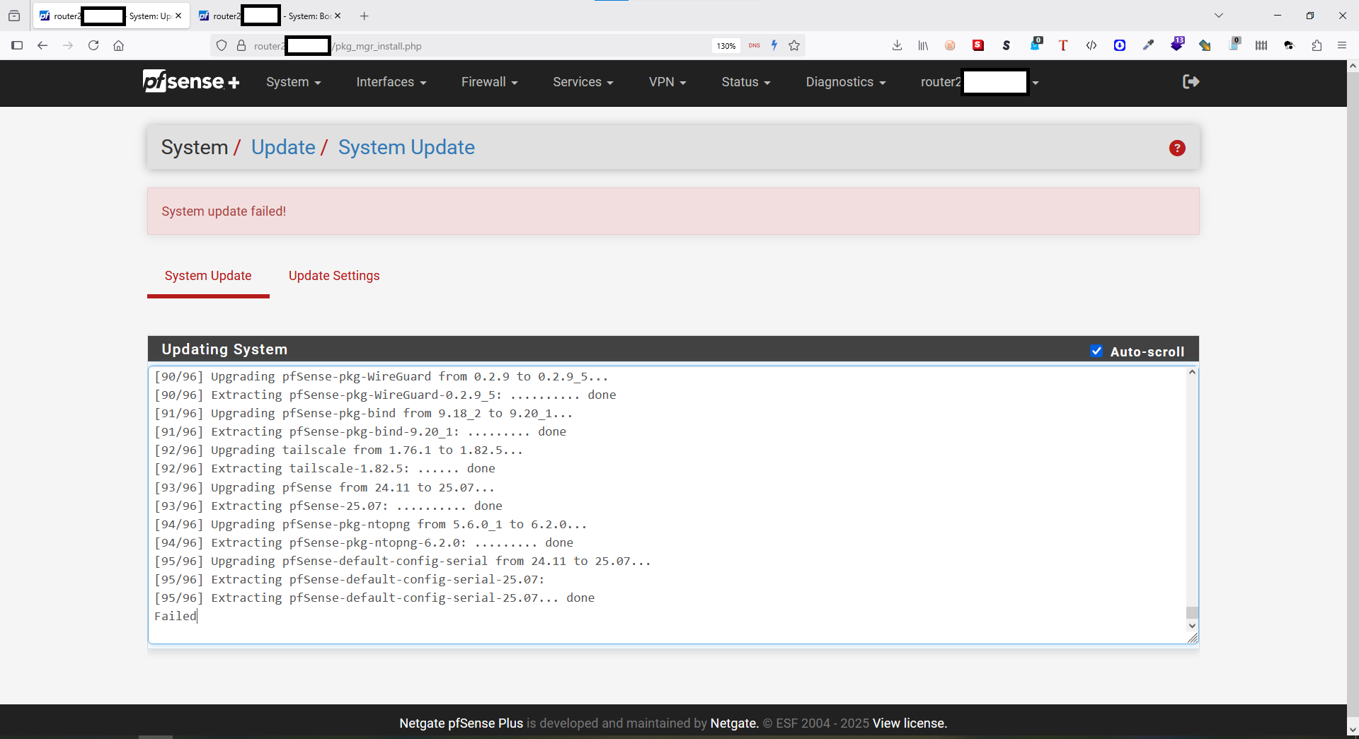

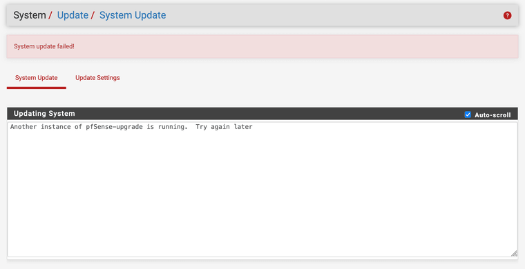

      For the first time I faced pfSense+ upgrade problem. So far I have successfully upgraded 4100 Base + NVME to 25.07 without any issues (BTW. it was fresh 24.11 reinstall with very low number of packages installed).
      Now I attempted to upgrade 24.11 to 25.07 and it failed. I think it literally did not start true upgrade - GUI log was like that:

      [1/96] Upgrading protobuf from 28.2,1 to 28.3,1...
      [1/96] Extracting protobuf-28.3,1: .......... done
      [2/96] Upgrading libuv from 1.49.1 to 1.49.2...
      [2/96] Extracting libuv-1.49.2: .......... done
      [3/96] Upgrading libnghttp2 from 1.63.0 to 1.64.0...
      [3/96] Extracting libnghttp2-1.64.0: .......... done
      [4/96] Upgrading protobuf-c from 1.4.1_6 to 1.4.1_7...
      [4/96] Extracting protobuf-c-1.4.1_7: .......... done
      [5/96] Upgrading bind-tools from 9.20.2 to 9.20.6...
      [5/96] Extracting bind-tools-9.20.6: .......... done
      [6/96] Deinstalling bind918-9.18.30...
      [6/96] Deleting files for bind918-9.18.30: .......... done
      [7/96] Upgrading python311 from 3.11.10 to 3.11.11...
      [7/96] Extracting python311-3.11.11: .......... done
      [8/96] Upgrading php83 from 8.3.12 to 8.3.19...
      [8/96] Extracting php83-8.3.19: .......... done
      [9/96] Upgrading php83-zlib from 8.3.12 to 8.3.19...
      [9/96] Extracting php83-zlib-8.3.19: ........ done
      [10/96] Upgrading expat from 2.6.3 to 2.7.1...
      [10/96] Extracting expat-2.7.1: .......... done
      [11/96] Upgrading py311-packaging from 24.1 to 24.2...
      [11/96] Extracting py311-packaging-24.2: .......... done
      [12/96] Upgrading php83-xml from 8.3.12 to 8.3.19...
      [12/96] Extracting php83-xml-8.3.19: ......... done
      [13/96] Upgrading glib from 2.80.5,2 to 2.80.5_1,2...
      [13/96] Extracting glib-2.80.5_1,2: .......... done
      [14/96] Upgrading libssh2 from 1.11.0_1,3 to 1.11.1,3...
      [14/96] Extracting libssh2-1.11.1,3: .......... done
      [15/96] Upgrading luajit-openresty from 2.1.20240815 to 2.1.20241104...
      [15/96] Extracting luajit-openresty-2.1.20241104: .......... done
      [16/96] Upgrading unbound from 1.22.0 to 1.23.0...
      ===> Creating groups
      Using existing group 'unbound'
      ===> Creating users
      Using existing user 'unbound'
      [16/96] Extracting unbound-1.23.0: .......... done
      [17/96] Upgrading curl from 8.10.1 to 8.11.0_1...
      [17/96] Extracting curl-8.11.0_1: .......... done
      [18/96] Upgrading openldap26-client from 2.6.8 to 2.6.9...
      [18/96] Extracting openldap26-client-2.6.9: .......... done
      [19/96] Upgrading libpfctl from 0.13 to 0.15...
      [19/96] Extracting libpfctl-0.15: ...... done
      [20/96] Upgrading php83-dom from 8.3.12 to 8.3.19...
      [20/96] Extracting php83-dom-8.3.19: .......... done
      [21/96] Upgrading php83-bcmath from 8.3.12 to 8.3.19...
      [21/96] Extracting php83-bcmath-8.3.19: .......... done
      [22/96] Upgrading php83-curl from 8.3.12 to 8.3.19...
      [22/96] Extracting php83-curl-8.3.19: .......... done
      [23/96] Upgrading boost-libs from 1.85.0 to 1.86.0...
      [23/96] Extracting boost-libs-1.86.0: .......... done
      [24/96] Upgrading php83-pdo from 8.3.12 to 8.3.19...
      [24/96] Extracting php83-pdo-8.3.19: .......... done
      [25/96] Upgrading harfbuzz from 10.0.1 to 10.1.0...
      [25/96] Extracting harfbuzz-10.1.0: .......... done
      [26/96] Upgrading libmaxminddb from 1.11.0 to 1.12.2...
      [26/96] Extracting libmaxminddb-1.12.2: .......... done
      [27/96] Upgrading nginx from 1.26.2_6,3 to 1.26.3,3...
      Using existing group 'www'
      ===> Creating users
      Using existing user 'www'
      [27/96] Extracting nginx-1.26.3,3: .......... done
      [28/96] Upgrading php83-filter from 8.3.12 to 8.3.19...
      [28/96] Extracting php83-filter-8.3.19: ......... done
      [29/96] Upgrading php83-pdo_sqlite from 8.3.12 to 8.3.19...
      [29/96] Extracting php83-pdo_sqlite-8.3.19: ......... done
      [30/96] Upgrading php83-ldap from 8.3.12 to 8.3.19...
      [30/96] Extracting php83-ldap-8.3.19: ........ done
      [31/96] Upgrading dnsmasq from 2.90_2,1 to 2.90_4,1...
      [31/96] Extracting dnsmasq-2.90_4,1: .......... done
      [32/96] Upgrading php83-simplexml from 8.3.12 to 8.3.19...
      [32/96] Extracting php83-simplexml-8.3.19: ......... done
      [33/96] Upgrading php83-bz2 from 8.3.12 to 8.3.19...
      [33/96] Extracting php83-bz2-8.3.19: ........ done
      [34/96] Upgrading php83-sockets from 8.3.12 to 8.3.19...
      [34/96] Extracting php83-sockets-8.3.19: .......... done
      [35/96] Installing if_pppoe-kmod-25.07.1500029...
      [35/96] Extracting if_pppoe-kmod-25.07.1500029: .. done
      [36/96] Upgrading php83-pfSense-module from 0.99 to 0.105...
      [36/96] Extracting php83-pfSense-module-0.105: ....... done
      [37/96] Upgrading opensc from 0.25.1 to 0.26.0...
      [37/96] Extracting opensc-0.26.0: .......... done
      [38/96] Upgrading php83-pcntl from 8.3.12 to 8.3.19...
      [38/96] Extracting php83-pcntl-8.3.19: ......... done
      [39/96] Upgrading php83-xmlreader from 8.3.12 to 8.3.19...
      [39/96] Extracting php83-xmlreader-8.3.19: ........ done
      [40/96] Upgrading php83-sqlite3 from 8.3.12 to 8.3.19...
      [40/96] Extracting php83-sqlite3-8.3.19: ......... done
      [41/96] Upgrading pfSense-repo from 24.11 to 25.07...
      [41/96] Extracting pfSense-repo-25.07: .......... done
      [42/96] Upgrading graphviz from 12.0.0 to 12.2.1...
      [42/96] Extracting graphviz-12.2.1: .......... done
      [43/96] Upgrading php83-session from 8.3.12 to 8.3.19...
      [43/96] Extracting php83-session-8.3.19: .......... done
      [44/96] Upgrading pfSense-composer-deps from 0.1 to 0.3...
      [44/96] Extracting pfSense-composer-deps-0.3: .......... done
      [45/96] Upgrading php83-sysvmsg from 8.3.12 to 8.3.19...
      [45/96] Extracting php83-sysvmsg-8.3.19: ........ done
      [46/96] Upgrading php83-shmop from 8.3.12 to 8.3.19...
      [46/96] Extracting php83-shmop-8.3.19: ........ done
      [47/96] Installing bind920-9.20.6...
      [47/96] Extracting bind920-9.20.6: .......... done
      [48/96] Upgrading py311-sqlite3 from 3.11.10_8 to 3.11.11_8...
      [48/96] Extracting py311-sqlite3-3.11.11_8: ........ done
      [49/96] Upgrading php83-gmp from 8.3.12 to 8.3.19...
      [49/96] Extracting php83-gmp-8.3.19: ......... done
      [50/96] Upgrading openvpn from 2.6.12 to 2.6.14...
      Using existing group 'openvpn'
      ===> Creating users
      Using existing user 'openvpn'
      [50/96] Extracting openvpn-2.6.14: .......... done
      [51/96] Upgrading php83-xmlwriter from 8.3.12 to 8.3.19...
      [51/96] Extracting php83-xmlwriter-8.3.19: ........ done
      [52/96] Upgrading php83-ftp from 8.3.12 to 8.3.19...
      [52/96] Extracting php83-ftp-8.3.19: ......... done
      [53/96] Upgrading radvd from 2.19_4 to 2.20...
      [53/96] Extracting radvd-2.20: .......... done
      [54/96] Upgrading ntp from 4.2.8p18_1 to 4.2.8p18_5...
      [54/96] Extracting ntp-4.2.8p18_5: .......... done
      [55/96] Upgrading php83-opcache from 8.3.12 to 8.3.19...
      [55/96] Extracting php83-opcache-8.3.19: .......... done
      [56/96] Upgrading php83-sysvshm from 8.3.12 to 8.3.19...
      [56/96] Extracting php83-sysvshm-8.3.19: ........ done
      [57/96] Upgrading php83-posix from 8.3.12 to 8.3.19...
      [57/96] Extracting php83-posix-8.3.19: ........ done
      [58/96] Upgrading pfSense-boot from 24.11 to 25.07...
      [58/96] Extracting pfSense-boot-25.07: .......... done
      [59/96] Upgrading php83-readline from 8.3.12 to 8.3.19...
      [59/96] Extracting php83-readline-8.3.19: ......... done
      [60/96] Upgrading miniupnpd from 2.3.7,1 to 2.3.7_1,1...
      [60/96] Extracting miniupnpd-2.3.7_1,1: ....... done
      [61/96] Upgrading ca_root_nss from 3.104 to 3.104_1...
      [61/96] Extracting ca_root_nss-3.104_1: ....... done
      [62/96] Upgrading kea from 2.6.1_1 to 2.6.2...
      [62/96] Extracting kea-2.6.2: .......... done
      [63/96] Upgrading dhcpcd from 10.1.0 to 10.2.0...
      [63/96] Extracting dhcpcd-10.2.0: .......... done
      [64/96] Upgrading php83-mbstring from 8.3.12 to 8.3.19...
      [64/96] Extracting php83-mbstring-8.3.19: .......... done
      [65/96] Upgrading php83-gettext from 8.3.12 to 8.3.19...
      [65/96] Extracting php83-gettext-8.3.19: ........ done
      [66/96] Upgrading rsync from 3.3.0 to 3.4.0...
      [66/96] Extracting rsync-3.4.0: .......... done
      [67/96] Upgrading socat from 1.8.0.1 to 1.8.0.2...
      [67/96] Extracting socat-1.8.0.2: ......... done
      [68/96] Upgrading php83-ctype from 8.3.12 to 8.3.19...
      [68/96] Extracting php83-ctype-8.3.19: ........ done
      [69/96] Upgrading php83-tokenizer from 8.3.12 to 8.3.19...
      [69/96] Extracting php83-tokenizer-8.3.19: ......... done
      [70/96] Upgrading bwi-firmware-kmod from 3.130.20 to 3.130.20.1500029...
      [70/96] Extracting bwi-firmware-kmod-3.130.20.1500029: . done
      [71/96] Upgrading php83-intl from 8.3.12 to 8.3.19...
      [71/96] Extracting php83-intl-8.3.19: .......... done
      [72/96] Upgrading pftop from 0.10_1 to 0.13...
      [72/96] Extracting pftop-0.13: ..... done
      [73/96] Upgrading php83-sysvsem from 8.3.12 to 8.3.19...
      [73/96] Extracting php83-sysvsem-8.3.19: ........ done
      [74/96] Upgrading py311-libzfs from 1.1.2023020700_2 to 1.1.2023020700_3...
      [74/96] Extracting py311-libzfs-1.1.2023020700_3: ........ done
      [75/96] Upgrading groff from 1.23.0_3 to 1.23.0_4...
      [75/96] Extracting groff-1.23.0_4: .......... done
      [76/96] Upgrading libfido2 from 1.15.0 to 1.15.0_1...
      [76/96] Extracting libfido2-1.15.0_1: .......... done
      [77/96] Upgrading nettle from 3.10_1 to 3.10.1...
      [77/96] Extracting nettle-3.10.1: .......... done
      [78/96] Upgrading cpu-microcode-amd from 20240810 to 20241121...
      [78/96] Extracting cpu-microcode-amd-20241121: ......... done
      [79/96] Upgrading cpu-microcode-intel from 20240910 to 20250211...
      [79/96] Extracting cpu-microcode-intel-20250211: .......... done
      [80/96] Upgrading pfSense-pkg-Cron from 0.3.8_5 to 0.3.8_6...
      [80/96] Extracting pfSense-pkg-Cron-0.3.8_6: .......... done
      [81/96] Upgrading pciids from 20240920 to 20241024...
      [81/96] Extracting pciids-20241024: ..... done
      [82/96] Upgrading pfSense-pkg-System_Patches from 2.2.20_5 to 2.2.22...
      [82/96] Extracting pfSense-pkg-System_Patches-2.2.22: .......... done
      [83/96] Upgrading iperf3 from 3.17.1 to 3.18...
      [83/96] Extracting iperf3-3.18: .......... done
      [84/96] Upgrading pfSense-kernel-pfSense from 24.11 to 25.07...
      [84/96] Extracting pfSense-kernel-pfSense-25.07: .......... done
      [85/96] Reinstalling pkg-1.21.3_5...
      [85/96] Extracting pkg-1.21.3_5: .......... done
      [86/96] Upgrading c-ares from 1.34.2 to 1.34.4...
      [86/96] Extracting c-ares-1.34.4: .......... done
      [87/96] Upgrading zip from 3.0_2 to 3.0_3...
      [87/96] Extracting zip-3.0_3: .......... done
      [88/96] Upgrading pfSense-base from 24.11 to 25.07...
      [88/96] Extracting pfSense-base-25.07: ... done
      ===> Keeping a copy of current version mtree
      ===> Removing schg flag from base files
      ===> Extracting new base tarball
      ===> Removing static obsoleted files
      [89/96] Upgrading pfSense-pkg-pfBlockerNG from 3.2.0_16 to 3.2.7...
      [89/96] Extracting pfSense-pkg-pfBlockerNG-3.2.7: .......... done
      [90/96] Upgrading pfSense-pkg-WireGuard from 0.2.9 to 0.2.9_5...
      [90/96] Extracting pfSense-pkg-WireGuard-0.2.9_5: .......... done
      [91/96] Upgrading pfSense-pkg-bind from 9.18_2 to 9.20_1...
      [91/96] Extracting pfSense-pkg-bind-9.20_1: ......... done
      [92/96] Upgrading tailscale from 1.76.1 to 1.82.5...
      [92/96] Extracting tailscale-1.82.5: ...... done
      [93/96] Upgrading pfSense from 24.11 to 25.07...
      [93/96] Extracting pfSense-25.07: .......... done
      [94/96] Upgrading pfSense-pkg-ntopng from 5.6.0_1 to 6.2.0...
      [94/96] Extracting pfSense-pkg-ntopng-6.2.0: ......... done
      [95/96] Upgrading pfSense-default-config-serial from 24.11 to 25.07...
      [95/96] Extracting pfSense-default-config-serial-25.07:
      [95/96] Extracting pfSense-default-config-serial-25.07... done
      Failed

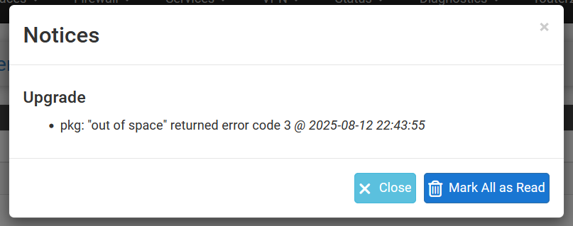

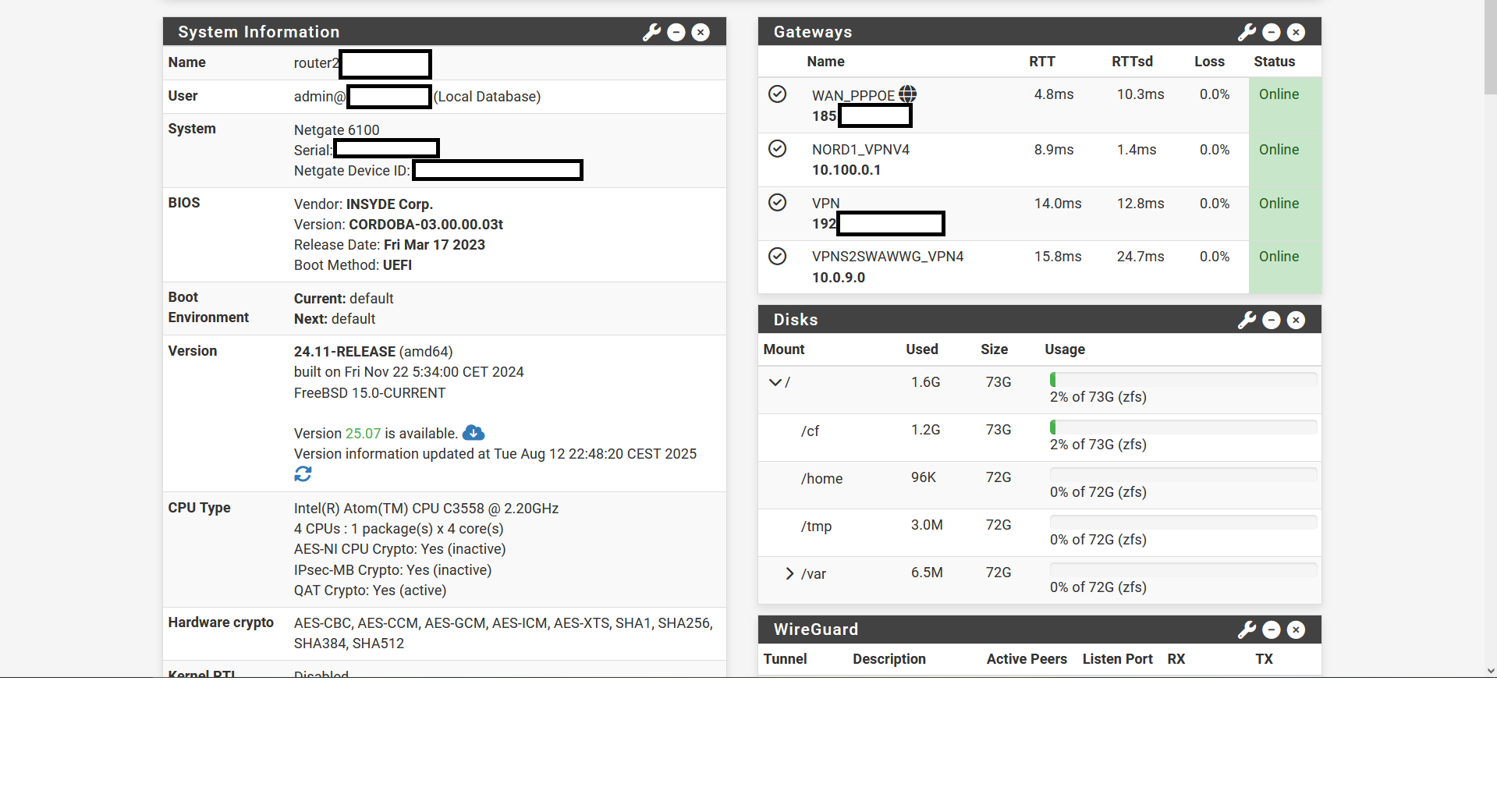

      The when I clicked pfSense+ logo to see Dashboard system notification about "out of disk space" appeared. This was a bit nonsense notification to me, because I immediately run "df -k" from GUI to learn that there is enough disk space.
      See the screens attached.
      I anonymised Dashboard screen so if you need some more details just PM me please. I may not respond immediately - just returned from holidays.
      BTW. 6100 Max is UEFI, ZFS and WAN is PPPoE (if that matters). I was connected via WireGuard Site-To-Site connection and it was "remote" upgrade of trusted site. Please assist kindly if possible.

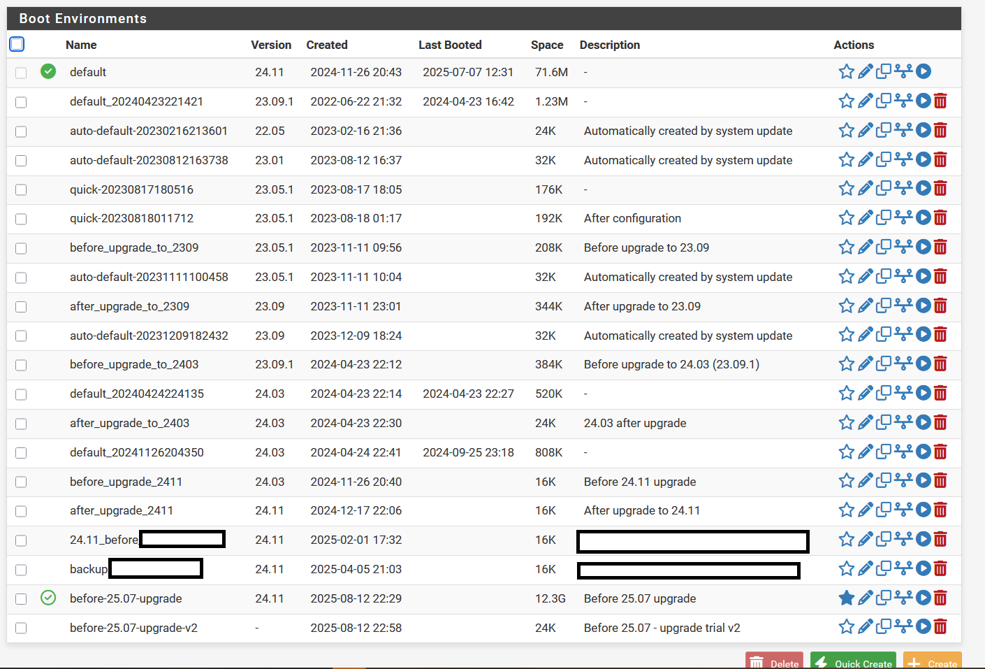

      There is a one extra thing that bothers me. I activated "before-25.07-upgrade" BootEnv snapshot that I took manually prior upgrade, but when I open upgrade "again" I see:

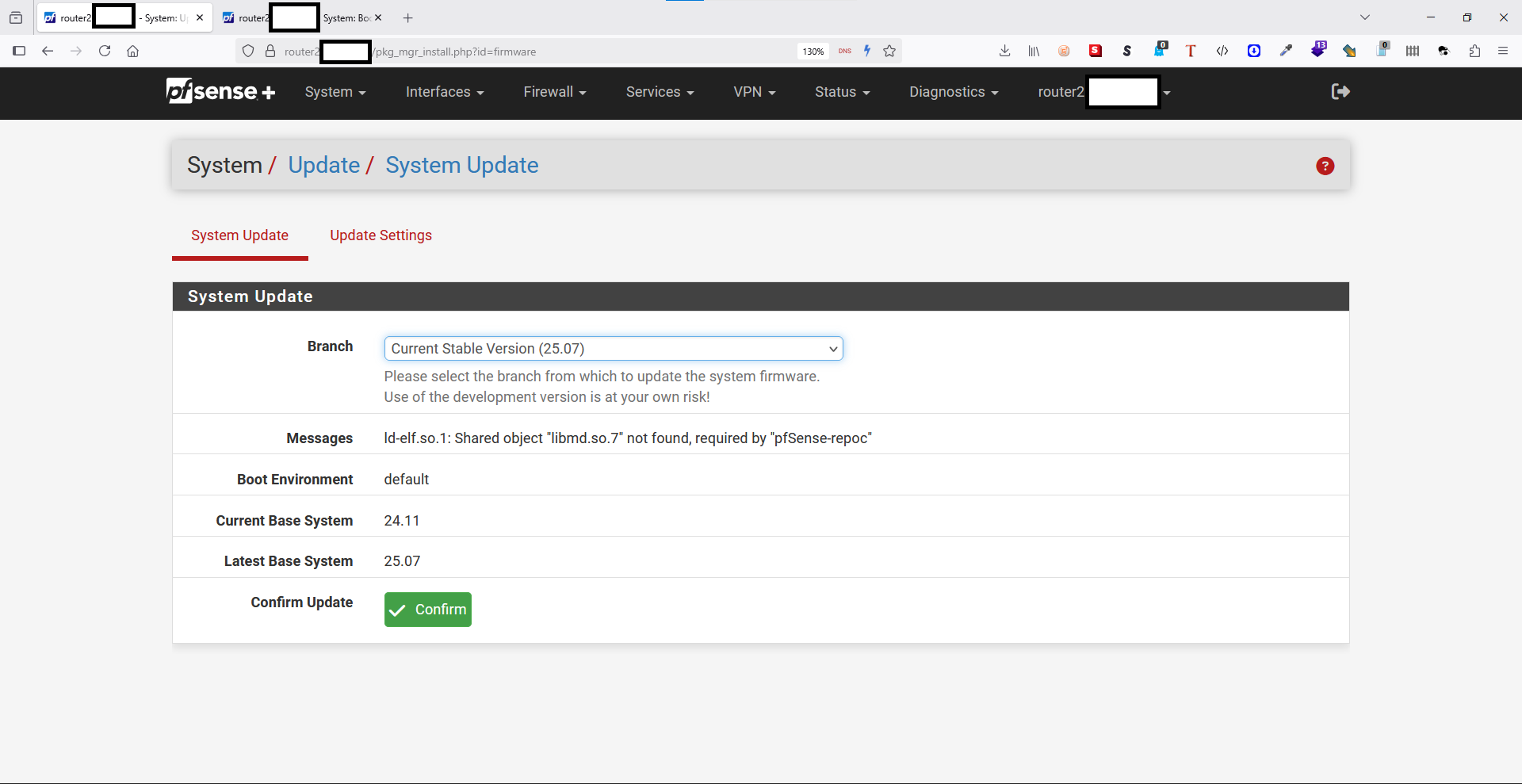

        @sandie Per other threads the shared object error is "normal" and will be gone after upgrade, IIRC.

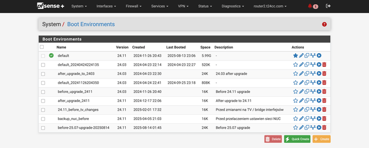

        Do you have a lot of boot environments?
        https://docs.netgate.com/pfsense/en/latest/troubleshooting/filesystem-shrink.html
        Upvote 👍 helpful posts!
          sandie @SteveITS
          @SteveITS 19 at the moment. Some created manually, some created automatically. The oldest is 22.05.
          I would give my hand that I did not see such a message prior upgrade. It made me concerned, because after reverting to manual BE snapshot I am having it (?).
          PS. I just checked 7100 DT (still 24.11) and message is: "Your Netgate device has pfSense+ as part of your device purchase.". I think it was like that prior 6100 upgrade attempt. Now it is no longer displayed like that [in 6100] even I reverted to previous snapshot (?).
          PS2. I will check more on zfs list -t snapshot. It is very late now. I reverted to previous snapshot and will continue tommorow evening or the day after tommorow. Maybe message about disk space was true as you said, but it looked like nonsense to me :)
            SteveITS Galactic Empire @sandie
            @sandie unless you really want to go back that far I’d delete the older ones. The space shown is totally misleading IMO…it’s more like 1 GB between versions.
            There are posts about that library error I just don’t have a link handy.

              Deleting some BE snapshots in GUI is not really working well to me - eg. I attempted to remove quick-20230818011712 and getting error:
              "The following input errors were detected:
              Unable to unmount boot environment "quick-20230818011712". Error 14"
              once BE screen is refreshed. Entries are disappering from BE menu, but they do not release disk space (?) - I am getting "unmount" errors. What should I do in terminal - zfs destroy ? What is safe to be destroyed from my list?

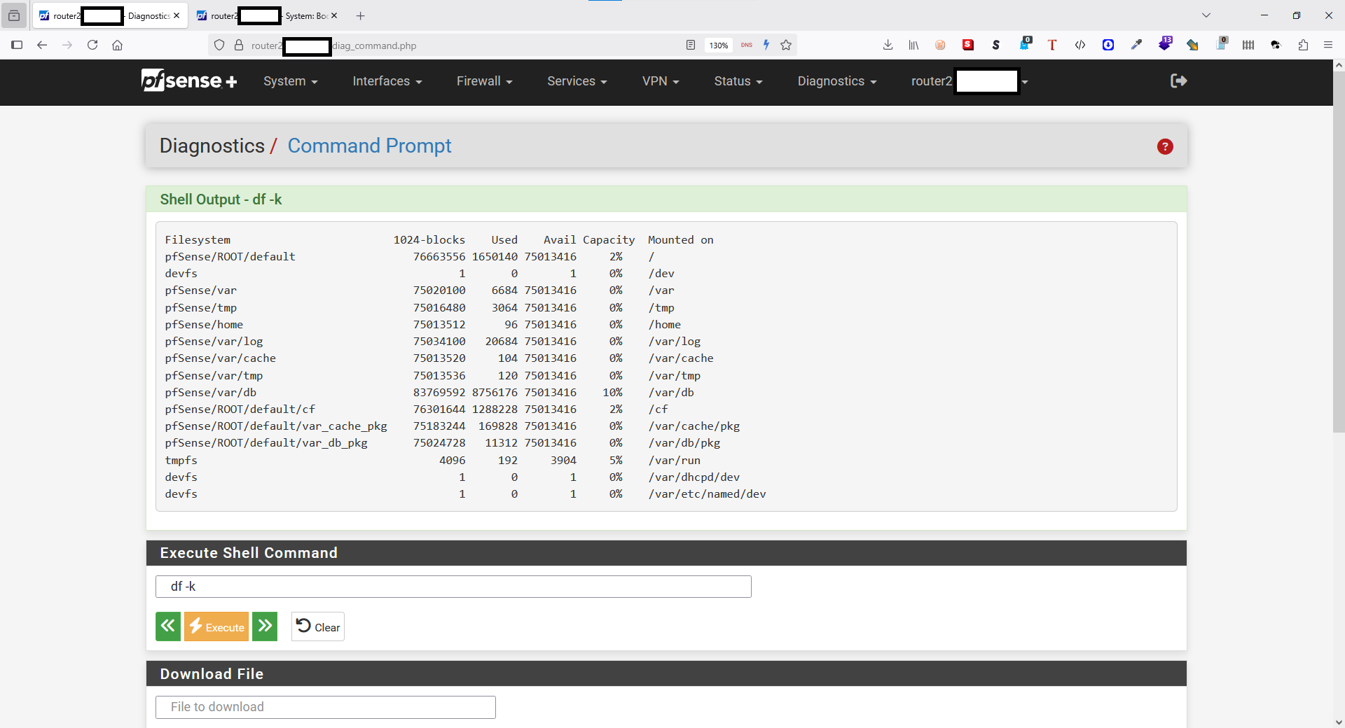

              Still something is messed with disk space (?), because having 17 x 1,5 GB is not 70 GB. Is there any command to check how much disk space is truly available?
                @sandie The dashboard should show the amount of used space. or "df -hi" command.
                check:
                https://docs.netgate.com/pfsense/en/latest/troubleshooting/filesystem-usage.html
                @stephenw10 may be able to help further...

                  I attempted to remove some BootEnv as suggested. None removed, but entries disappeared from BootEnv list. Therefore I run [in sequence] commands from output: output2.txt
                  As you see I must have used "-R" to remove some snapshot and dependant snapshots (?). Entries in menu were always disappearing, but always displayed error that snapshot is in use or so (message pasted in previous comment).
                  Whatever I try now (eg. upgrade again) I am always getting:
                  "Another instance of pfSense-upgrade is running. Try again later"
                  in System / Update / System Update in "Updating System" iframe. System does not want to update and seems to be stuck.
                  Screenshot 2025-08-13 at 21-20-33 router2.t24cc.com - System Update System Update.png
                  Manual removal of some snapshots did not help. "df -hi" does not show much diskspace occupied (see command output at the very bottom of in output2.txt file).
                  @SteveITS I think message about diskspace running out was nonsense message.

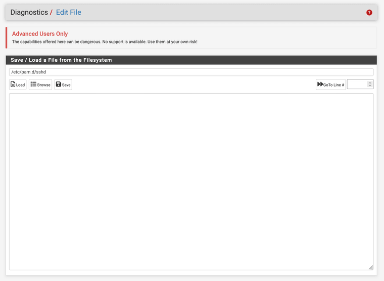

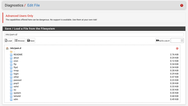

                    I can not load /etc/hosts.allow and /etc/hosts.deny in 6100 Diagnostics / Edit File (anymore?). /etc/pam.d/sshd seems to be empty upon loading too (!).
                    Screenshot 2025-08-13 at 22-38-45 router2.t24cc.com - Diagnostics Edit File.png
                    Screenshot 2025-08-13 at 22-40-21 router2.t24cc.com - Diagnostics Edit File.png
                    In theory some files exist with non-zero/correct size, but when attempted to be loaded nothing loads. Filesystem is screwed or what? :( I also see ntopng is being constantly restarted.
                    How it is possible that dir displays correct filesizes, but they simply do not load content in GUI?
                    24.11 is having similar filesizes and loads files in GUI properly.

                        Failed
                        It started true upgrade and failed a bit further (7/96) and immediately displayed notification:
                        "Notices
                        Upgrade
                        pkg: "out of space" returned error code 3 @ 2025-08-14 01:53:11
                        Screenshot 2025-08-14 at 02-00-59 router2.t24cc.com - System Boot Environments.png
                        As you see I removed some BootEnv prior this attempt and everything looked right, but upgrade failed AGAIN. Could WAN PPPoE be a factor here? It failed in different place though than last time.
                        Something must be BROKEN with upgrade process. Output of df -hi:
                        Filesystem                            Size    Used   Avail Capacity iused ifree %iused  Mounted on
                        pfSense/ROOT/default                   80G    1.6G     79G     2%     65k  165M    0%   /
                        devfs                                 1.0K      0B    1.0K     0%       0     0     -   /dev
                        pfSense/var                            79G    6.5M     79G     0%     169  165M    0%   /var
                        pfSense/tmp                            79G    3.0M     79G     0%     433  165M    0%   /tmp
                        pfSense/home                           79G     96K     79G     0%       7  165M    0%   /home
                        pfSense/var/log                        79G     19M     79G     0%    1.5k  165M    0%   /var/log
                        pfSense/var/cache                      79G    104K     79G     0%       9  165M    0%   /var/cache
                        pfSense/var/tmp                        79G    120K     79G     0%      20  165M    0%   /var/tmp
                        pfSense/var/db                         86G    7.4G     79G     9%    4.5k  165M    0%   /var/db
                        pfSense/ROOT/default/cf                80G    1.0G     79G     1%    5.6k  165M    0%   /cf
                        pfSense/ROOT/default/var_cache_pkg     79G    166M     79G     0%      27  165M    0%   /var/cache/pkg
                        pfSense/ROOT/default/var_db_pkg        79G     11M     79G     0%      28  165M    0%   /var/db/pkg
                        tmpfs                                 4.0M    192K    3.8M     5%      55   14k    0%   /var/run
                        devfs                                 1.0K      0B    1.0K     0%       0     0     -   /var/dhcpd/dev
                        devfs                                 1.0K      0B    1.0K     0%       0     0     -   /var/etc/named/dev
                        and zfs list -t snapshot:
                        NAME                                                       USED  AVAIL  REFER  MOUNTPOINT
                        pfSense/ROOT/default@2024-04-23-22:30:33-0                 544K      -  1.53G  -

                        The difference is I do not notice problems with SSH and missing/unreadable files, eg. /etc/pam.d/sshd. SSH is working - I can connect and see console even though "System upgrade failed"
                          As long as THAT is your error while upgrading...

                          Both output BEFORE 24.11 -> 25.07 upgrade. Diskspace is not a factor here?
                          YES it is. All snapshots need space and you have A LOT of them. I don't know why you need that many and with 24.03 switching the behavior of updates, I don't understand why you manually do snapshots BEFORE upgrading, as the current BE running is NOT touched, but a new one created and that one is updated - then switched over. So the box can fail back when the update fails. So it's unnecessary to sit on that much older snaps when you have no real use for them. Before/After makes no sense, als the "old 24.03" and "new default" are literally the "before"/"after". I haven't had the need for a BE for "oh I need to have the exact situation right before/after the update" ever but perhaps you did? I don't know, just wanted to let you know you have a lot of IMHO obsolete snaps here that serve minimal to no purpose (at least for my limited knowledge of you setup).
                          Check the dashboard disk and ZFS widget! They show the really used space and if there's less then ~2.5GB of space free, the latest update to 25.07 won't run. I just came back from a call with a customer that had the exact problem with a 4100 and 5 old BEs. Deleted all up to the 24.03 one so only 2 were left and voilà the free space jumped up to around 8GB instead of ~2 before the removals. Hit upgrade again - box updated without a hitch.
                          Would have attached pics, but unfortunately that seems broken (at least for me right now).
                          Boot Environments - didn't look too bad?
                          Disk Widget - showed the problem - far less capacity then needed (8GB eMMC version)
                          ZFS widget showed ~2.66GB left free - that's not enough for the update.
                          Cheers :)
