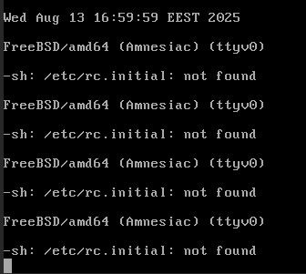

      Trying to update the ACME to 1.0 from 0.9_1 and it completely breaks the system beyond repair instantly and system stops booting as well.
      Upgrading pfSense-pkg-acme...
      Fetching meta.conf:
      Fetching data.pkg:
      Fetching meta.conf:
      Fetching data.pkg:
      The following 5 package(s) will be affected (of 0 checked):
      Installed packages to be REMOVED:
      bind-tools: 9.20.6
      pfSense: 2.8.0.1500029
      protobuf: 28.3,1
      protobuf-c: 1.4.1_7
      Installed packages to be UPGRADED:
      pfSense-pkg-acme: 0.9_1 -> 1.0 [pfSense]
      Number of packages to be removed: 4
      Number of packages to be upgraded: 1
      The operation will free 120 MiB.
      277 KiB to be downloaded.
      [1/1] Fetching pfSense-pkg-acme-1.0.pkg: .......... done
      [1/5] Deinstalling pfSense-2.8.0.1500029...
      [1/5] Deleting files for pfSense-2.8.0.1500029: ........
      then GUI goes
      https://fqdn:9443/pkg_mgr_install.php
      404 Not Found
      nginx
      and finally if system is rebooted
      johnpozJ S 4 Replies Last reply Reply Quote 0

                    Failed to figure out what was that - probably some broken deps- I've had zenarmor manually installed and crowdsec.
                    I actually had that in the system - removed
                    rm /usr/local/etc/pkg/repos/Zenarmor.conf
                    rm /usr/local/etc/pkg/repos/FreeBSD.conf
                    rm /usr/local/etc/pkg.conf
                    but that didn't change anything I ended up fresh installing 2.7.2 from ISO, then upgrading to 2.8 and then restoring config (can't use netinstall as new installer doesn't want to connect to my pppoe during setup for unknown reason - so I can't use it, but it works just perfectly fine in GUI)
                    Now the issue is resolved and I've installed acme just fine... can't tell what was that - I've been using pfsense maybe 10+ years.

                          Same issue, completely broke my system as soon as I started the package upgrade. I could not even SSH into the system and upon rebooting the system it would not boot anymore. I had to also restore from a backup. I have never had a package in pfsense completely hose the system like that.
                          When I ran the reinstall of 2.8.0 l restored the config directly from the drive and everything is working. The ACME package is also on version 1.0 after the restore now.

                                The OP of this thread had unsupported packages installed from third-party repositories, which is almost certainly where the problem originated. It doesn't matter if the repo configs were removed -- if local packages were installed/changed by those repos, those packages are still present.
                                While we do not deliberately break such configurations, if you install a package from unsupported repositories and they replace or mess with base system dependencies, then there is no telling what will break over time like this.
                                One of many reasons we discourage using anything but Netgate repositories for packages.

                                    OK I've done some additional testing, as I was curios what the hell is happening - so I can now confirm installing crowdsec with their packages breaks further packages installation system completely.. regardless cli or UI.. not sure about 2.7.2 but 2.8.0 got completely broken
                                    I used that:
                                    https://docs.crowdsec.net/docs/next/getting_started/install_crowdsec_pfsense/
                                    Then I've also tried to install qemu-guest tools and to reinstall ACME - the very same situation with REMOVE packages... so crowdsec breaks the system I believe. I'm too lazy to report to their github, I guess I'll just avoid them until official support from Netgate.
