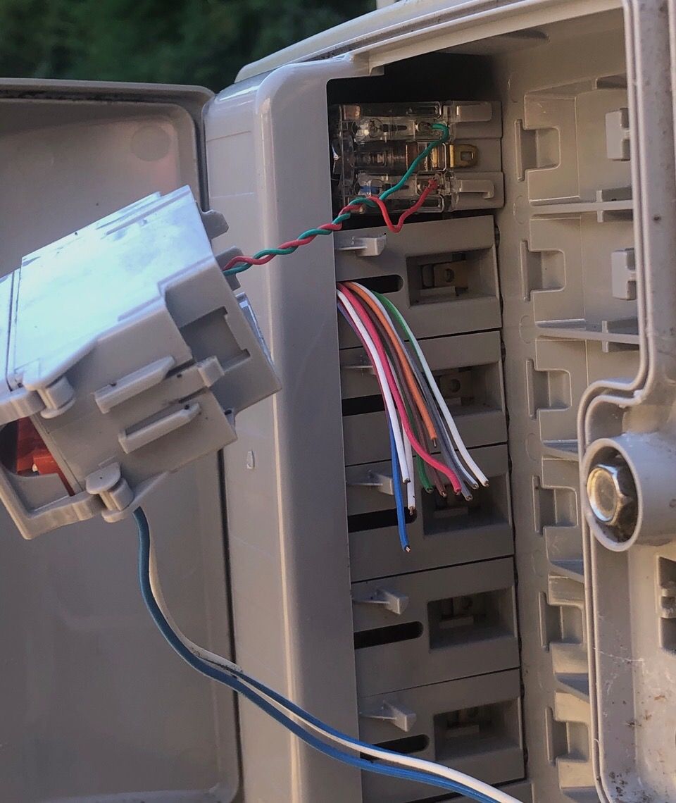

      The Centurylink technician twisted the wires on our side going into their side and the coating on the red wire is degraded as it enters their side does anyone know if I could be held accountable to pay for the visit today? ![alt text](image url)dsl.jpg

        But I'm failing to see what the issue is here? The connection failed?

              I checked everything and the only issue I can see is that area that has a degraded coating. I was getting low DSL quality for a long time and figured it finally gave out. They are supposed to be out here on August 19 but I was wondering if I could do it myself. Probably not a good idea.

                DSL for me wasn't that hard to work on. I don't think the twist makes much, if any, difference. I'm sure others would know better, but I used UTP for inside wiring and it worked fine between the TNI and the modem.
                Here's something you can do to test whether it's your inside wiring or CL's outside wiring. Move your DSL modem from wherever it is to the TNI. Unplug your house side from the TNI RJ-11 jack and plug the modem in there. Turn it on and test whether your DSL works. If it works, it's your inside wiring to wherever you were plugging it in. If it doesn't work, it's CL's outside wiring.
                Inside wire noise can kill DSL. It's essential you have DSL filters on all your telephone devices to the wall jack or a whole-house splitter that sends the DSL only to your modem and the voice only to the house jacks. If you just added a telephone device in the house without a filter that could be the problem. Another test is to unplug every phone device in the house from the wall jack and then test the DSL again where it usually plugs in and at the TNI.
                If the problem is inside wiring, CL will charge you for it. If it's their outside wiring, they probably won't.
                (I've found their techs, once you can get their Elbonian call center to dispatch them to you, to be helpful and enjoyable to work with. And I've found their techs almost to a person hate their job and employer and can't wait to retire.)
                An added test is to plug a standard phone into the same RJ-11 test jack on the TNI. If you get a dial tone, the voice circuit is working. If you don't, of course, it's dead and it's not you, it's them.
                My experience is the voice can work and the DSL not work at the same time. But when the voice was down, both were down.

                  Just from the photo there's nothing obviously wrong. The insulation being stripped back a bit further than necessary isn't going to stop it working. But, yes, if you have voice service and that's still working that proves that particular connection is still good at least.
