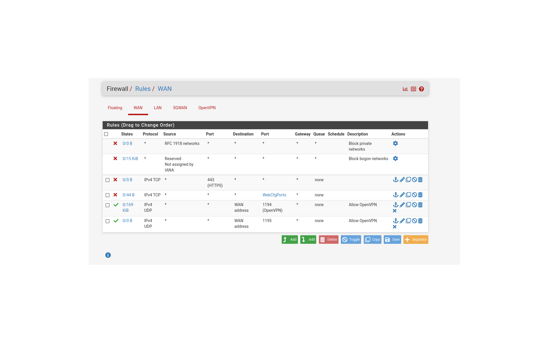

      here's my wan rules:
      clearly blocking 443, yet external nmap show 80,443, and 22 wide open. FYI WebCfgPorts=443,80,22(all three of which are wide open on the nmap scan).
      	States 	Protocol 	Source 	Port 	Destination 	Port 	Gateway 	Queue 	Schedule 	Description 	Actions
      	0/0 B
      * 	RFC 1918 networks 	* 	* 	* 	* 	* 		Block private networks
      	0/15 KiB
      * 	Reserved
      Not assigned by IANA * * * * * Block bogon networks
      0/0 B
      IPv4 TCP * 443 (HTTPS) * * * none
      0/44 B
      IPv4 TCP * * * WebCfgPorts * none
      0/169 KiB
      IPv4 UDP * * WAN address 1194 (OpenVPN) * none Allow OpenVPN
      0/0 B
      IPv4 UDP * * WAN address 1195 * none Allow OpenVPN

                      BTW your attempt at blocking 443, you have 443 as the source port.. That isn't going to be something you would normally every see.

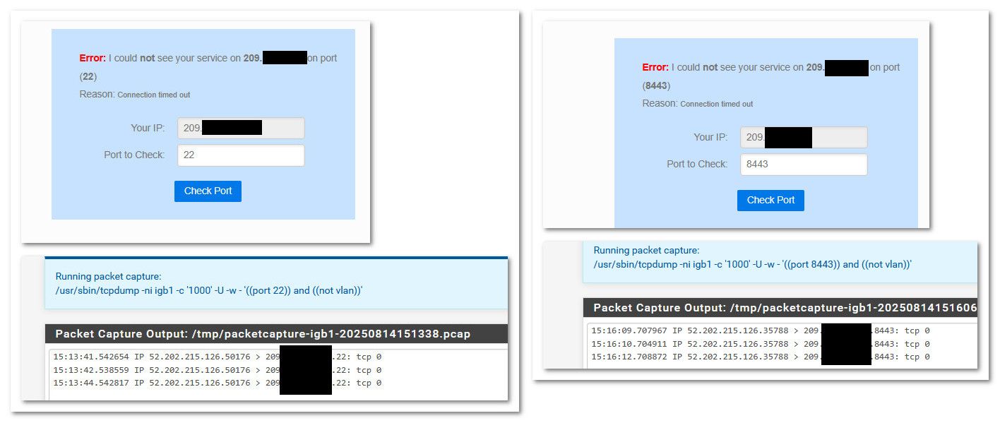

                      You sure its not something in front of pfsense answering.. Do your packet capture on your wan, do your scan from external - you see that traffic specific hit your pfsense, and an answer.. So your state table with this traffic and pfsense answering. For pfsense to see traffic and answer you would for sure see both of those things.
                      example: Here is outside hitting my ports.. both 22 and 8443 which is what my gui listens on. But as you can see no answers, since I have no rules that would allow that traffic on my wan or in my floating tab.

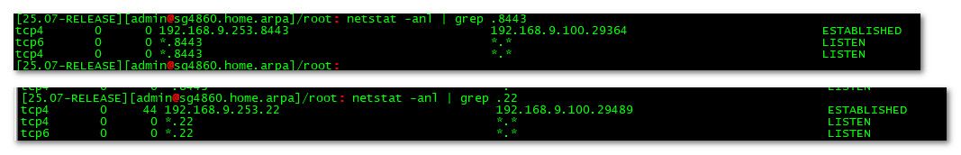

                      Here you see that those are the ports in use, and you can see my PC currently connected to them via the lan IP.

                        @EricAiken Check https://docs.netgate.com/pfsense/en/latest/troubleshooting/firewall.html#new-rules-are-not-applied ... you should not need to add a block rule since the default rule is to block.
                        Your fourth rule to block to WebCfgPorts has matched something (0/44B).
