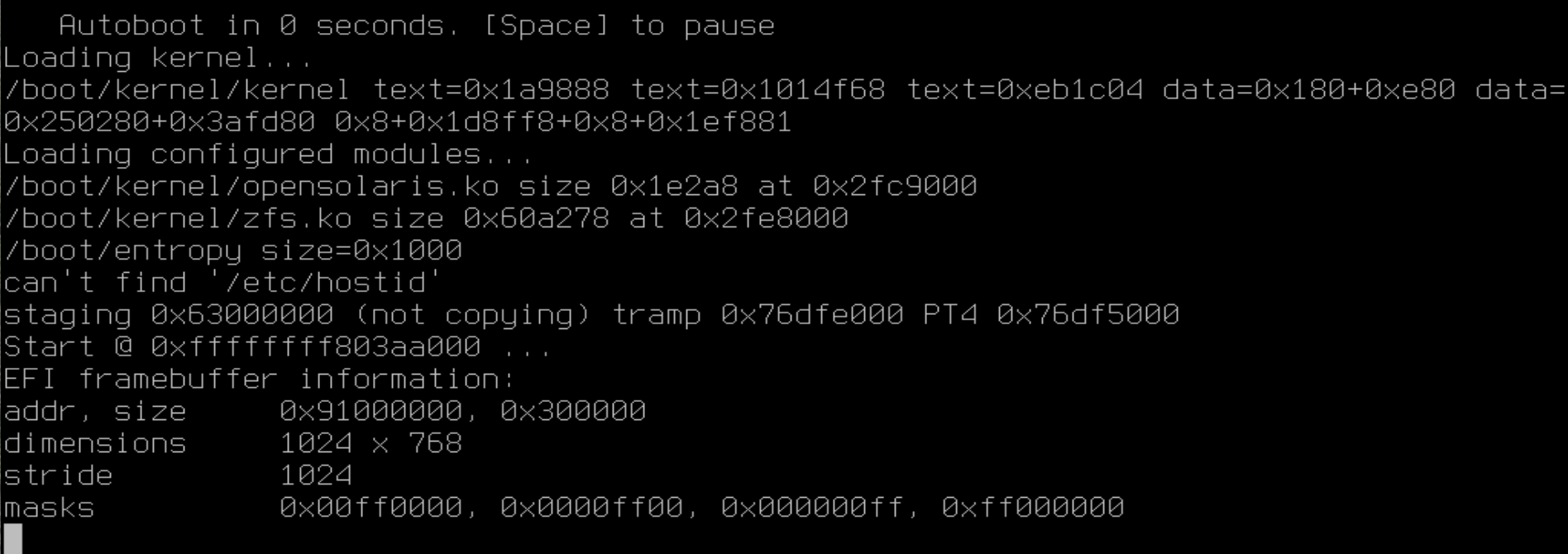

                              I have multiple HP servers, some are PFsense, and some are PFsense+ and I am running into the same issue. For example on PFsense if I am on 2.7.2, when I try and update to 2,8 it breaks the server so it's no longer bootable.
                              So I loaded an older PFsense I had on an HPE DL360 G9, to see what happened with a fresh system. The update to 2.8 broke as expected, and above you can see what happens. Then the server just resets and starts the boot process again. Every HP I own has this issue it seems, I have tired it on G10's as well, with no luck.
                              Any ideas?
                              Posted here as it seems like this is a related thread..

                                @WB3FFV if think in the past when booting froze at that point it was an issue with console settings.
                                Can you compare the boot variables (interrupt at the boot menu by pressing 3, then show) from 2.7.2 and 2.8.0?
                                Are you booting using UEFI or legacy BIOS?
                                  Are you able to test 25.07.1 on an affected system?
