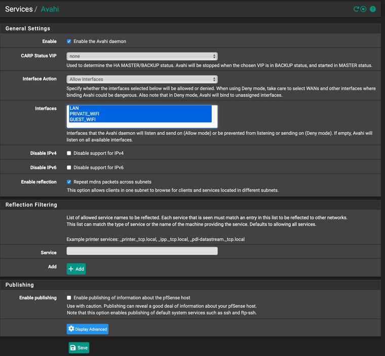

                      Maybe I spoke too soon... I moved a working printer (Canon MF743) from one room to another, powered it up, it connected to the same WiFi network (PRIVATE_WIFI) and I attempted to print from the LAN, but printer was not found.
                      The network consists of a wired LAN, a PRIVATE_WIFI and a GUEST_WIFI. The LAN is 172.16.1.x, and PRIVATE_WIFI, where the printer is connected, is 172.16.10.x. The AP is an Airport Extreme set to Bridge mode. Router is a 2100 running 25.0.7.1.
                      Avahi is set to repeat all 3 networks. Nothing special is configured. The LAN has an allow all to any rule.
                      I deleted the printer from the LAN Mac's printer list and attempted to re-add it. It showed up as a Bonjour printer, but trying to add it failed with an error that there was no communication.
                      It gets a little weirder - if I instead added the printer via its IP address, the printer is successfully added. If I then go back to add the printer again via Bonjour it sees it and is able to add it.
                      Even after printing to the Bonjour added printer, I don't see any ARP Table entries for the printer.

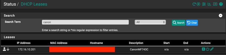

                      There is a static DHCP entry for the printer but it's listed as down in DHCP Leases. The printer is set to DHCP and reports it's using that IP.

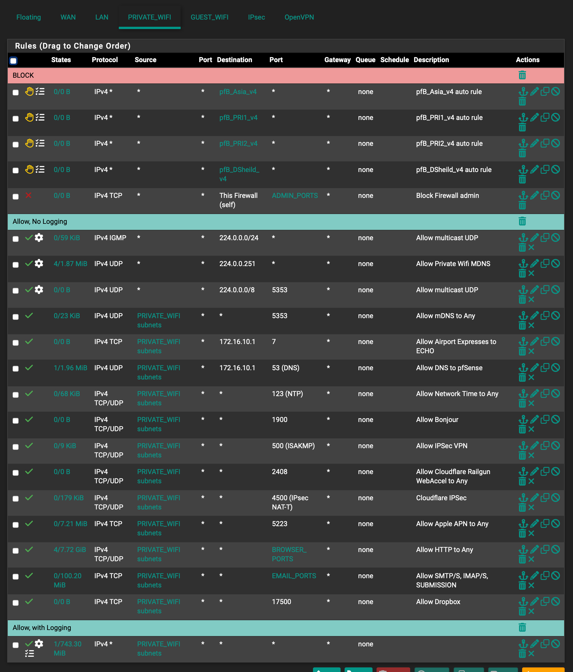

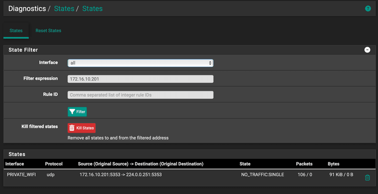

                      Here are my LAN and PRIVATE_WIFI rules, the Avahi configuration, the printer states and the lease. Is it strange that there are no ARP table entries for the printer or states between the LAN Mac and the printer right after printing?
                      What do I not have setup correctly so that I couldn't add the printer via Bonjour from the LAN? Apologies for the basic questions. It's working now but I'm interested in learning why it didn't work without first adding the printer via its IP.
                          The host and printer are in different network segments, yes? As such, you would not expect to see a ARP entry. ARP is only used for addresses in the local network segment.
                          Have you checked the firewall log? Do you have default logging enabled?

                              I power-cycled it and forced it to renew its lease and it did. As I stated above, pfSense has a static DHCP IP set for the printer, and that's the IP the printer got, but pfSense says the lease is down as shown in the last pic above. Could this be Kea related?

                                      Gertjan @terryzb
                                      @terryzb said in 25.07 and Avahi?:
                                      The printer uses DHCP - and get an MAC Static lease from pfSense (using kea, or ISC).
                                      As soon as the lease was granted, the pfSense ARP cache will 'know' about the relation MAC-printer and it's IP 172.16.10.201 address. This ARP cache will auto empty - after some 20 minutes or so (I don't recall).
                                      If pfSense (itself) re connect to this printer, the pfSense ARP cache will contain the IP of the printer again.
                                      But : does pfSense print ? Normally, a router firewall doesn't use a printer. So no big deal it loses the ARP cache info.
                                      Ping from pfSense your printer, and you'll see the DHCP lease shows a green up arrow again (for a while).
