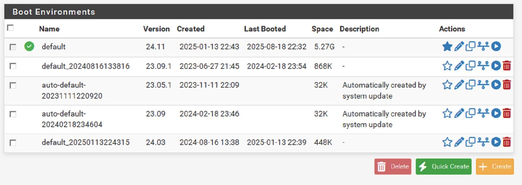

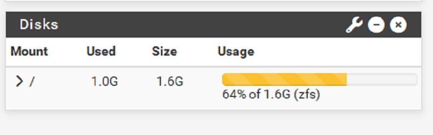

        Do you see an alert on the dashboard after trying that?
        The most common issue there is running out of disk space due to old BE snapshots taking up space. Remove any old BE snaps you're no longer using in System > Boot Environments.
        • P Offline
          packergeek @stephenw10
          I have this message.
          ld-elf.so.1: Shared object "libmd.so.7" not found, required by "pfSense-repoc"

          I don't have any packages installed other than what came with it. Here is a picture of the boot environmentsPFsense.jpg .
          • SteveITSS Offline
            SteveITS Rebel Alliance @packergeek
            @packergeek So remove the older versions there unless you think you might revert back to them.

              @SteveITS That's 1mb of space if I delete the 24.04-23.09.1 That will allow me to do the upgrade? Doesn't seem like it's freeing any real space.
              Here is a disk picture of the disk usage on the front page.
              Nevermind. It freed up a chunk of space. I guess it's the actual size.
              • SteveITSS Offline
                @packergeek yeah the size is misleading
                Upvote ๐Ÿ‘ helpful posts!
                  That ^,
                  It's actually taking up far more space. That error: pkg: "out of space" returned error code 3 confirms it out of disk space.
                  I would remove all but the current and one previous BE and run the upgrade again.
