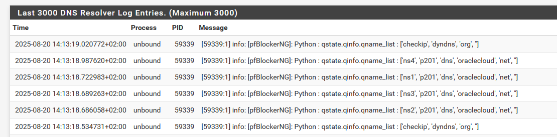

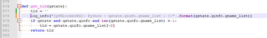

        To understand the issue, I added the 'log_info(...) line :
        I saw :
        What happened is : host names must be - probably not ( !) use utf-8encoding.
        Somehow, the pfSense resolver unbound was 'fed' with a host names that contains a 'utf-8' charterer, your "0xc0", and unbound use uses the pythonmod scrip /var/unbound/pfb_unbound.py - to parse (check for DNSBL) and that one can't handle utf-8 chars. It fails.
        How to deal with this ?
        If you know what device was asking for these 'illegal' ? ** host names, stop it doing so ?
        Or, add the line as I've show above, so you know what host name is the one that fails. That could give you an indication who (what device) was asking for it.
