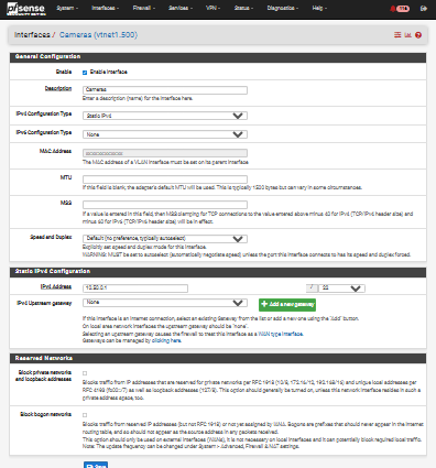

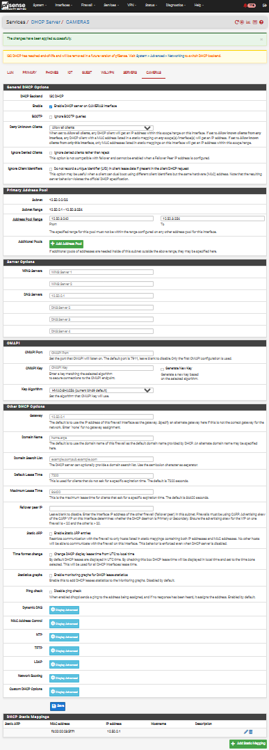

      For the past couple of years, I've had VLAN setup and it's been working fine. I am now trying to setup a new VLAN for my IP cameras.
      I assigned port 5 on my managed switch to VLAN 500. I added VLAN 500 in pfSense and setup DHCP for VLAN 500.
      When I connect my laptop to that port on the switch, my laptop just says "unknown network" and gets an ip address beginning 192 (I forgot to write down the actual address.
      When I assign this switch port to VLAN 100, my laptop successfully gets an IP address that is within the VLAN 100 DHCP parameters.Interfaces.png DHCP.png

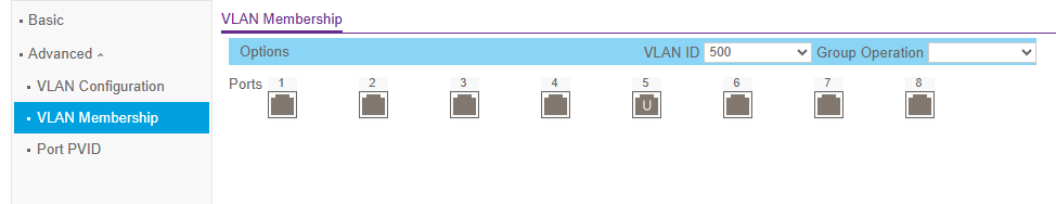

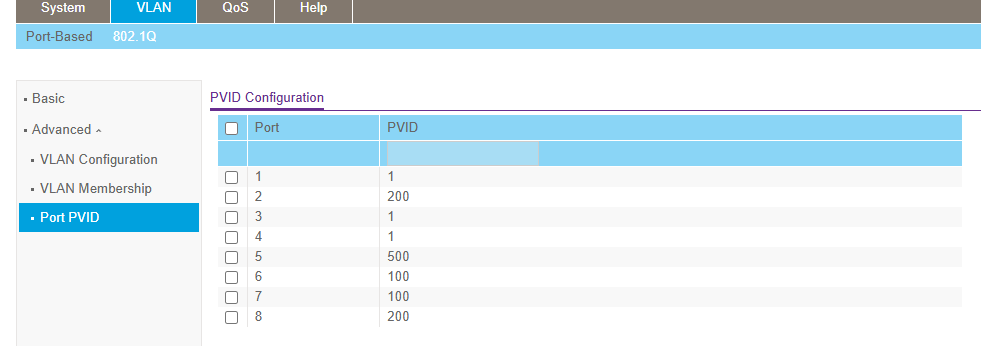

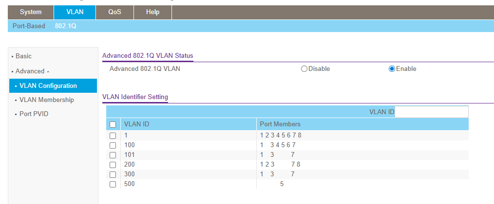

      Here are screenshots of the managed switch VLAN settings.

        On the switch you have to add the trunk port to the VLAN 500 to connect it to pfSense.

          I'll double-check when I get home tonight. But I thought I did have it in the trunk.
