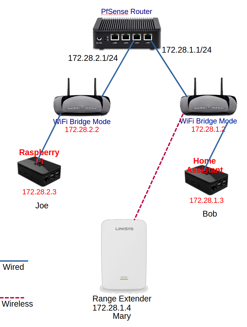

            I'll work on drawing a diagram
              DaHai8 @DaHai8
              Hope this helps
                SteveITS Galactic Empire @DaHai8
                @DaHai8 If Mary is a router providing NAT there’s a subnet behind Mary. What IP does a device there have?
                Upvote 👍 helpful posts!
                  DaHai8 @SteveITS
                  @SteveITS said in Solving Ranger Extender subnet with a Route in pfSense?:
                  Same IP addresses as w/o Mary. For instance the Camera is at 172.28.1.25 regardless of being connected to Mary Range Extender (172.28.1.4) or direct to the Wifi Bridge (172.28.1.2)

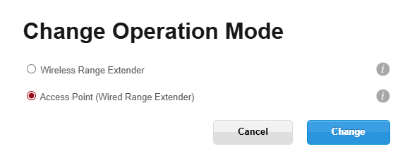

                    Ok, just for Giggles, I changed the mode on Mary (the Wireless Range Extender) to Wired Access Point and connected an Ethernet cabled from the Wifi Bridge (172.28.1.2) to it:
                    And, as I suspected in my original post, this works...grrr
                    I can Ping and access Mary from any other subnet on pfSense (like the Raspberry Pi on 172.2.3) and any device connected to Mary.
                    None of the IP addresses on any of the devices (including Mary) changed. But everything works and my network on 172.28.1.0/24 is "extended".
