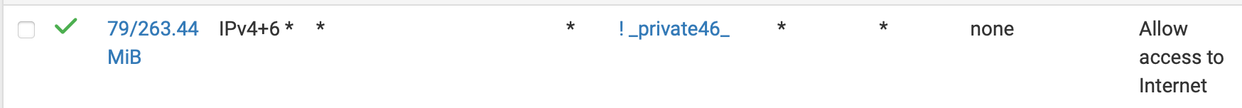

      At first I thought this might be a problem with the server. But executing the very same command directly on pfSense works perfectly fine. I tried it on multiple machines on multiple VLANs. Typically I have a rule to allow internet access like this in place:
      When I turn logging on for this rule, I can see, that pfSense allows the connection.
