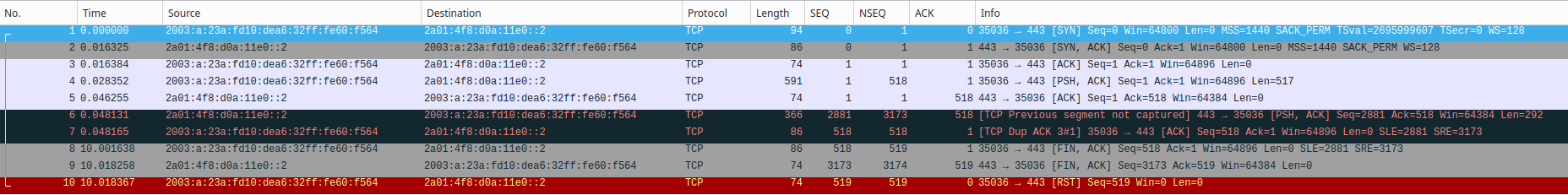

      I took network traces on the raspi. What I see there is that the TCP handshake is OK (small packets), and I think also the get request goes out OK (packet no. 4 with length 591).
      When I take a trace on pppoe0 and make a working curl-call in the pfsense, I see the same packets going in and out, but then a couple of big packets come in, which contain the payload I guess (packets 6 and 7)
      Now all of this looks not very exciting. ICMP "Packet too big" is dropped by some paranoid filter, IPv6 black hole, that's it.
      BUT first of all: I don't see any such ICMP packet coming in on pppoe0. There is no ICMP traffic at all on pppoe0 when I run the curl call on the raspi.
      Secondly: I just don't have no firewall rule that would block ICMP.
      I suspect that the pfSense is misbehaving. The reason for this is that I played around with NPt. And I read somewhere that "Packet too big" messages get lost when NPt is active. However, I disabled NPt completely and deleted any related config. And anyway there are no packet-too-big packets anyway, so none can get lost.
      If someone is interested I can provide the trace files.
      Does anyone here have any idea what steps I could take next?

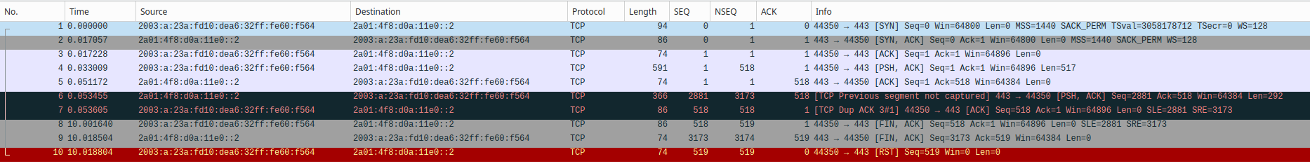

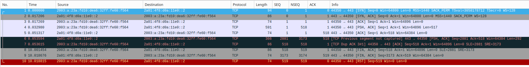

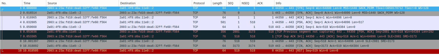

        Hi all,
        let me put one additional info here. I made another call to https://www143.your-server.de on the Raspi, and traced on the Raspi itself (eth0), on the LAN interface of pfSense (igb1) and on the WAN interface of pfSense (pppoe0).
        Result:
        eth0:
        igb1:
        pppoe0:
        As you see, the packets are exactly the same, i.e.: nothing is dropped.
        The only difference is that packets on pppoe0 are always 10 bytes larger than on igb1 and eth0. As it seems, outgoing packets grow, incoming packets shrink. No idea why that is. I have no VPN or other encapsulation techniques, other than pppoe. But does pppoe trigger this 10 bytes difference?
        Again, thanks for any hint.
        PS: pls note that LAN is on igb1, not igb0 (my mistake in the first posting)
