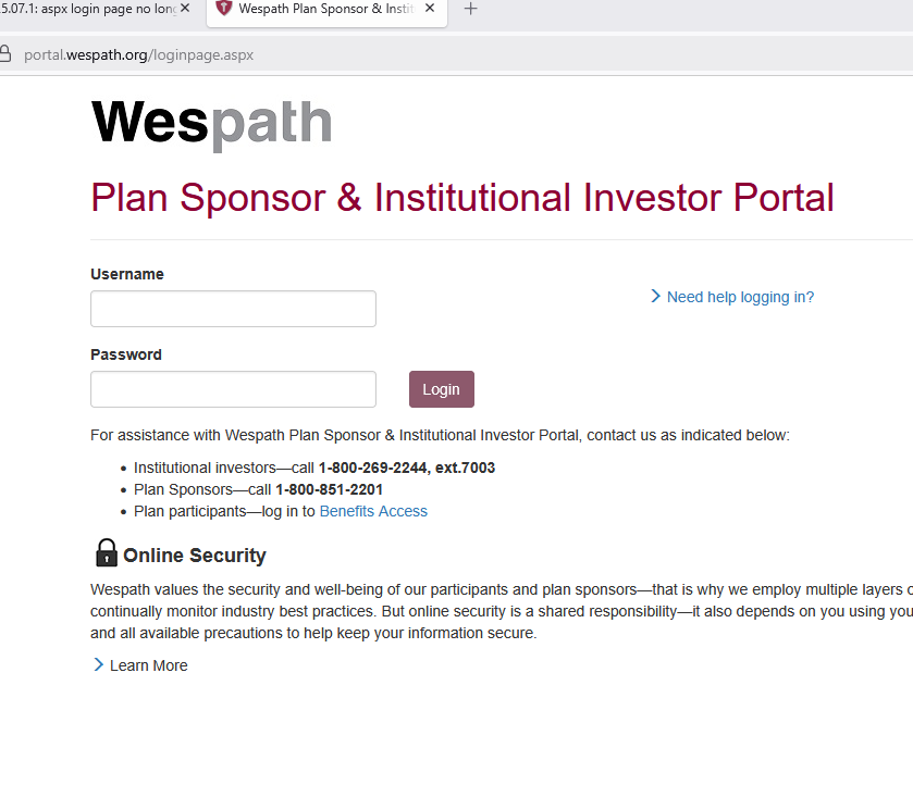

      Access to this webpage worked in 24.11, but not 25.07.1, need help please...
      https://portal.wespath.org/loginpage.aspx

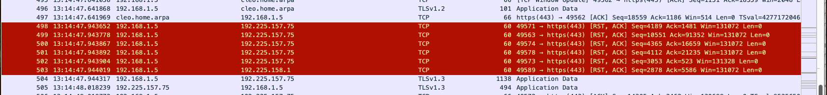

      For networks without pfsense in use, it loads a full login page. On my two systems with pfsense 25.07.1, I only get the word "Wespath" and nothing else. This webpage worked on my Netgate 2100 back in 24.11, rules haven't changed since the upgrade to 25.07.1 this past Sunday. It also won't load with my Netgate 1100 either. Stared at the syslogs, nothing blocked. Turned on logging for 80 and 443, no clue there either. Did a quick tcpdump (attached) from my local system (192.168.1.5; cleo.home.arpa is the firewall) to the webpage and stared at it with wireshark. I get a blast of red in wireshark at the end, see screengrab. Any ideas what is going on and how to fix?
      packetcapture-mvneta0.4091-20250826131441.pcap
      Netgate 1100 and Netgate 2100, latest pfsense+ version

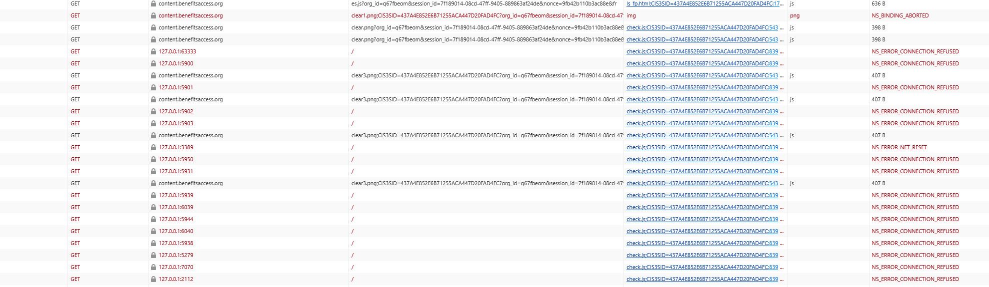

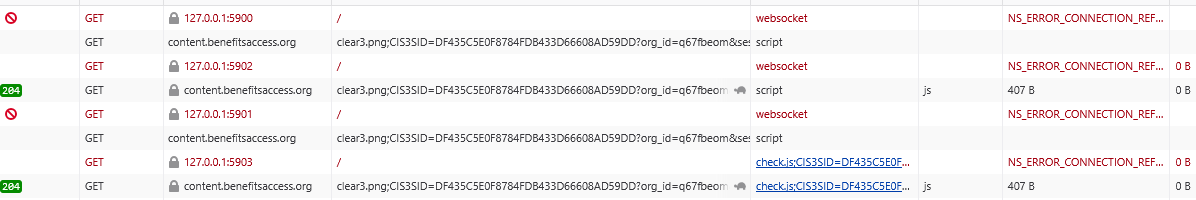

        SteveITS Rebel Alliance @beerguzzle

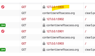

        I was all set to say "that can't be" but I see the same thing. However Firefox's network panel shows multiple connections to localhost for 590x (VNC?) and 3389 (RDP). Maybe the site is infected? Not sure how the router software version can be relevant to that though.

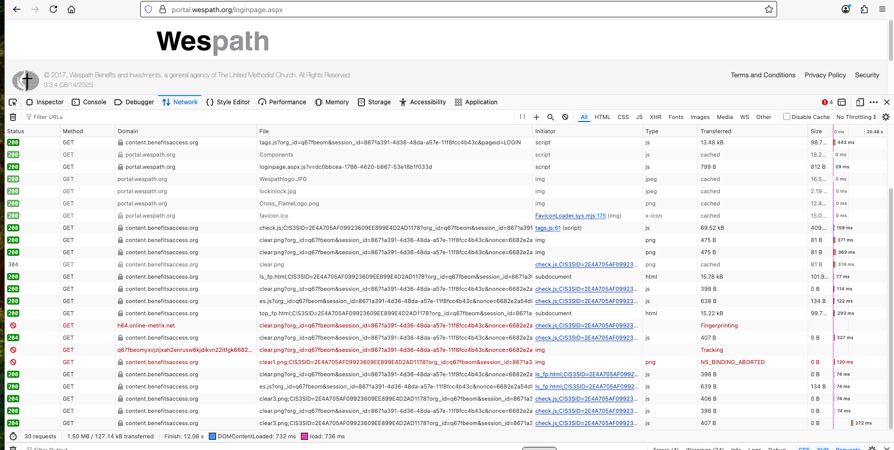

        • beerguzzleB Offline
          beerguzzle @SteveITS
          @SteveITS On a Mac, latest OS. With Firefox 142.0, I see the attached info with Web Dev Tools->Network. Where do you see ports 3389 or 590x in your output?? I see zilch in the way of loopback traffic, and I also see zero in the way of port information on my network info in Firefox. Seeing port info beyond 80/443 would be nice. It is the same picture with Safari (version 18.6) under Web Inspector->Network.
          FYI, I don't allow either port 3389 or 590x traffic in my firewall rules.
            @beerguzzle This part:
            Seemed odd for it to be doing anything with localhost. I didn't screen cap the 127.0.0.1:3389 but it was in the list.
            I didn't specify but I had pulled it up on another PC+location first and didn't see the partial page load, though didn't view the network tab there. Maybe it's hitting different web servers? (speculation)

              • T Offline
                terryzb @beerguzzle
                @beerguzzle

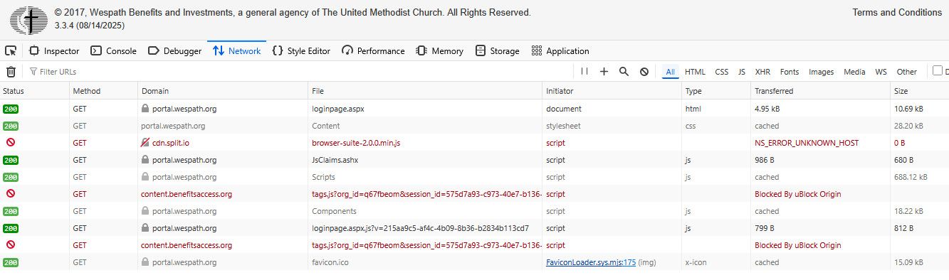

                Only the isolated "Wespath" text. I see these errors in the javascript console.

                  @beerguzzle here is what I see
                  This is blocked by my pihole
                  Found 2 adlists exactly matching 'cdn.split.io'.
                    - https://raw.githubusercontent.com/StevenBlack/hosts/master/hosts (block)
                      - cdn.split.io
                    - https://raw.githubusercontent.com/blocklistproject/Lists/master/basic.txt (block)
                      - cdn.split.io
                  And then that benefitaccess.org is blocked by ublock origin
                  Yeah all I get is that wespath black gray logo or whatever... If I turn off ublock.. I get a bunch of crap to loopback on bunch of different ports
                  This isn't a pfsense issue that is for sure.
                  • w0wW Offline
                    w0w @beerguzzle
                    @beerguzzle said in 25.07.1: aspx login page no longer loads, did in 24.11:
                    just an isolated "Wespath" logo?
                    Chrome, Edge all the same — just logo. Do you have pfBlocker enabled?
                      Gertjan @beerguzzle
                      Looks fine to me :
                      They probably had some cleaning to do ?

                        @beerguzzle only logo on Firefox/macOS 142.0/aarch and piHole. Same as for johnpoz, cdn.split.io blocked. content.benefitsaccess.org blocked by upstream DNS (Control D, StevenBlack Unified list)

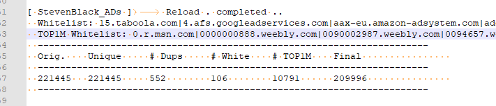

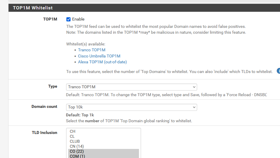

                              Gertjan @beerguzzle
                              I run pfblockerng, with StevenBlack ADs in my DNSBL feeds. Via command line in /var/db/pfblockerng, doing a "find . -type file -print | xargs grep cdn.split.io" there it was in his list. So I went to pfBlockerNG/DNSBL, went down to DNSBL Whitelist and added cdn.split.io there. Then force reloaded, and checked that the site resolved on my firewall. Then cleared the DNS cache on my Mac, and voila the webpage loaded correctly.
                              I consider having to whitelist cdn.split.io an ugly fix to my problem. But it is a fix.
                              I use the Stevens list to, and did't had to whitelist what so ever.
                              Yes, "cdn.cdn.split.io" is in Stevens list, I found it.
                              But it'a also in the top Tranco TOP1M that I sue :
                              so that explains why I didn't had any issues. "cdn.cdn.split.io" is auto whitelisted for me as I don't want to have deal with :
                              The TOP1M feed can be used to whitelist the most popular Domain names to avoid false positives.
                              When I searched in line 8476 (a very long line, thousands of hosts (10791 !) are listed in there, I found "cdn.cdn.split.io". So it was filtered out, among 106 others - see image.
                              Not ugly.
                              When you chose a list, you take it as a whole. If any false positives exits in it, you have to white list them all.
                              The perfect list for you ... can only be created (and maintained) by .... you ;)
                                SteveITS Rebel Alliance @johnpoz
                                @johnpoz I thought about that but here the two ports I noticed as the page loaded were 3389 and 5900 (counting up). Which seems not so random. I didn't let it run very long. I was just trying to see if something wasn't loading.
                                And FWIW the 27.07 router I have does have pfBlocker blocking ads, and the other doesn't, but I wasn't going to try it on the other one again.

                                  johnpoz LAYER 8 Global Moderator @SteveITS
                                  @SteveITS yeah those ports do stick out for sure.. And do seem odd for sure.. You wouldn't run your own app on those ports - those are for sure for rdp and vnc..
