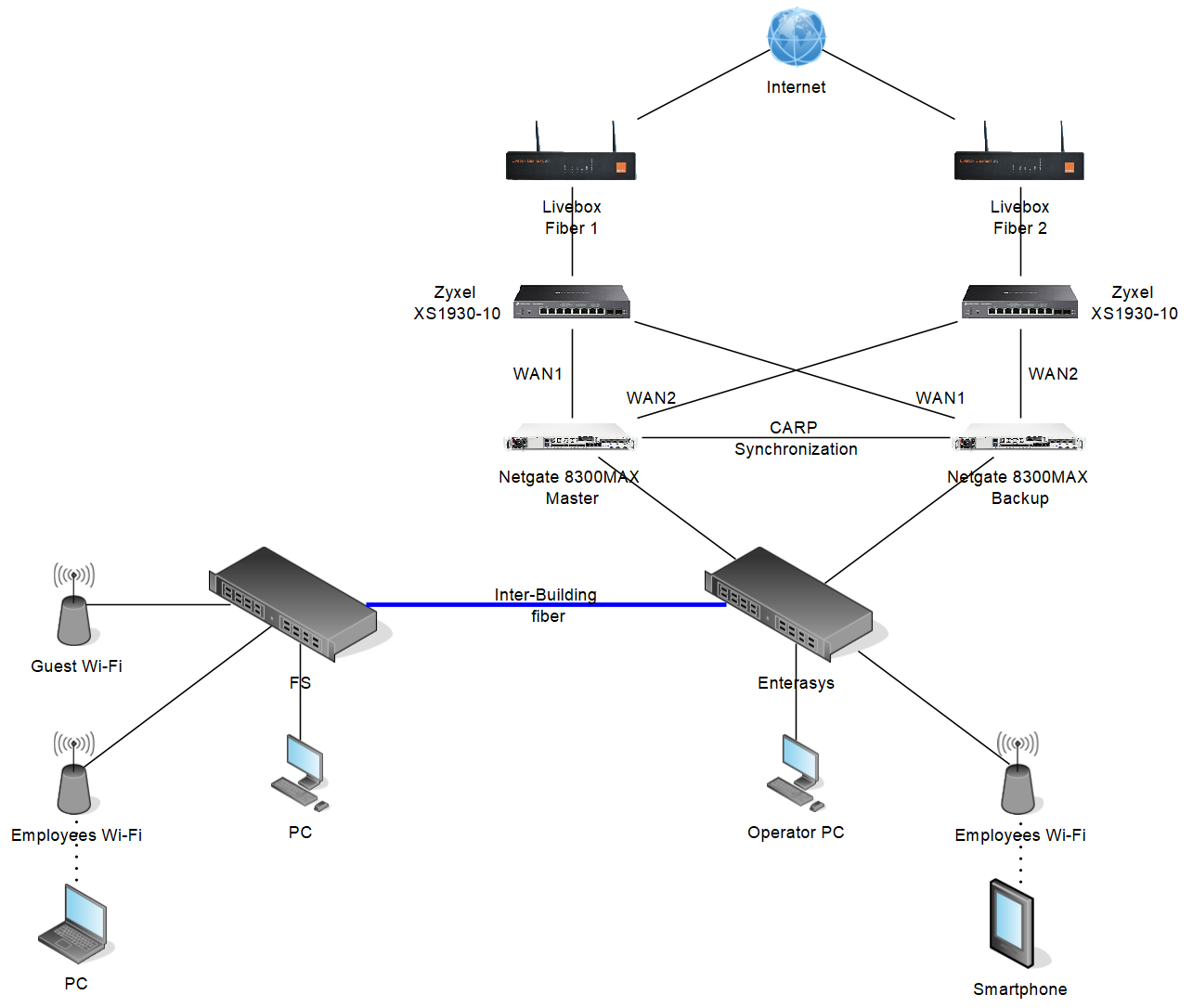

      I want to upgrade my network that is currently a multi-WAN CARP HA built around 2 8300-MAX appliances :
      As you can see, there are 2 big problems on that network :
      • The Zyxel switches placed upstream of appliances are distributing one fiber each. I want to use them to build a MSTP network (I already assigned a VLAN for each fiber) ; I don't know how to do that.
      • Enterasys and FS switches placed downstream of appliances are SPOF (especially Enterasys that is the heart of the entire LAN, both buildings are off if there's a problem on it).

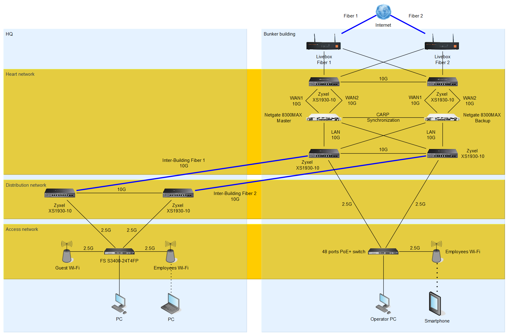

      This is my vision of the future network:
      In this vision, I need help:
      • How to connect both appliances and both new LAN Zyxels and make sure CARP is still working properly ?
      • Are the upstream "old" Zyxels correctly connected between them, appliances and ISP routers ? Do you think CARP will still work properly too in that side of the network ?
      • Is the 3-layer network correct ?
