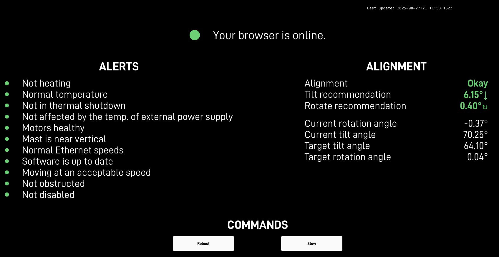

      The dish status page appears normal:
      Star Debug then showed no IPv6.

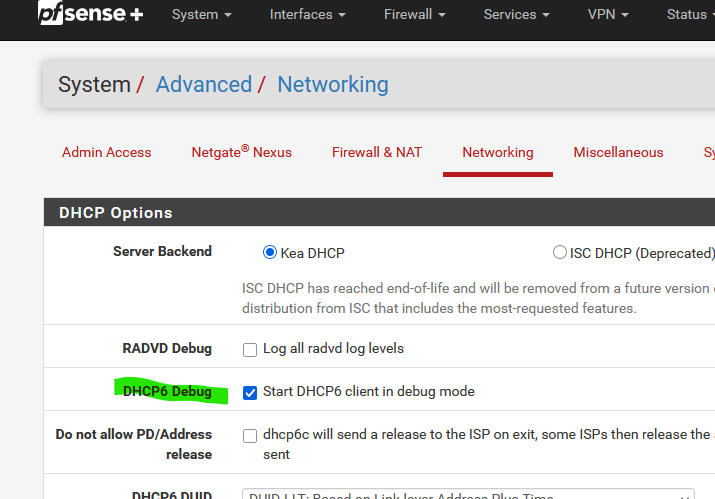

        and from now on the DHCP log will show if a WAN IPv6 and prefixe(s) are obtained.

          After digging some more, I tried today to see if Gemini could come up with one and it found an ipv4 and ipv6 at the Phoenix PoP that appears to tie in Starlink to the peering network. I've switched to those and will see how it goes. I'll also turn on IPv6 debug in Kea. Thanks for the idea.
