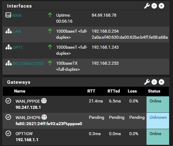

      After upgrading to 25.07.1 I seen there was a new PPPoE client available (if_pppoe).
      However I am having problems getting IPv6 to work properly if this is enabled.
      If I disable it and use the old client everything works as normal.
      It doesn't appear to get a connection when looking at the gateway monitoring-
      Looking at the logs I can see these messages-
      Could that be something to do with it?
      Within pfSense itself I can ping an IPv6 address from (Diagnostics -> Ping) successfully.
      Is there something I am missing here? Any help would be appreciated.

        Can pfSense itself ping something like ipv6.google.com if you pick the right interface?
        • G Offline
          GaZaai @w0w
          @w0w Yes it can! From (Diagnostics -> Ping) it can ping an IPv6 address from the WAN interface successfully.

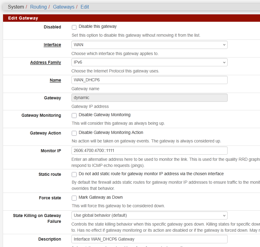

            Try to set Monitor IP as workaround…

              @w0w If I were to put an IPv6 address in there the gateway just sits at pending even on the old pppoe client. I think it’s because my WAN interface is using a link local address. I think my ISP only uses prefixes and not a full address.

                I’ve seen this behavior before on the forum in another thread.
                I can’t find it now, but you could try disabling the gateway monitoring action to see if it helps—just for debugging, not as a permanent solution.
                Maybe someone from Netgate can provide a better answer. Perhaps @stephenw10 could help?
                • G Offline
                  GaZaai @w0w
                  @w0w Thank you that fixed the issue and I now have IPv6 working with the new if_pppoe kernel 👍
                  Regarding the IPv6 monitoring, do you think that is possibly a bug? As how come pfSense can ping IPv6 sites fine from the Diagnostics section but the gateway monitoring is unable to ping the same address?
