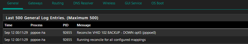

                      @perrin as below the only log i have. i clicked the reconcile now button.

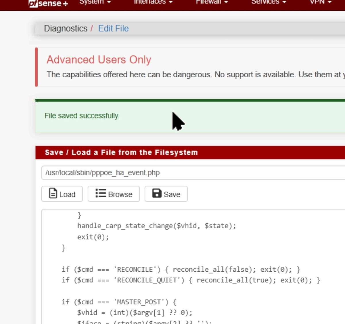

                      • P Offline
                        perrin @zjamali

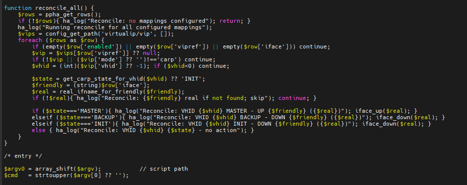

                        @zjamali i suspect that i might have an old pkg in the github repo. can you please check the file pppoe_ha_even.php (in /usr/local/sbin) and check if the function reconcile_all (line 176ff) looks like this:
                        function reconcile_all() {
                            $rows = ppha_get_rows();
                            if (!$rows){ ha_log("Reconcile: no mappings configured"); return; }
                            ha_log("Running reconcile for all configured mappings");
                            $vips = config_get_path('virtualip/vip', []);
                            foreach ($rows as $row) {
                                if (empty($row['enabled']) || empty($row['vipref']) || empty($row['iface'])) continue;
                                $vip = $vips[$row['vipref']] ?? null;
                                if (!$vip || ($vip['mode'] ?? '')!=='carp') continue;
                                $vhid = (int)($vip['vhid'] ?? -1); if ($vhid<0) continue;
                                $state = get_carp_state_for_vhid($vhid) ?? 'INIT';
                                $friendly = (string)$row['iface'];
                                $real = real_ifname_for_friendly($friendly);
                                if (!$real){ ha_log("Reconcile: {$friendly} real if not found; skip"); continue; }
                                if ($state==='MASTER'){ ha_log("Reconcile: VHID {$vhid} MASTER - UP {$friendly} ({$real})"); iface_up($real); }
                                elseif ($state==='BACKUP'){ ha_log("Reconcile: VHID {$vhid} BACKUP - DOWN {$friendly} ({$real})"); iface_down($real); }
                                elseif ($state==='INIT'){ ha_log("Reconcile: VHID {$vhid} INIT - DOWN {$friendly} ({$real})"); iface_down($real); }
                                else { ha_log("Reconcile: VHID {$vhid} {$state} - no action"); }
                        the script should log the set interface states (UP, DOWN) in the log - thats why I am wondering...
                        zjamaliZ 1 Reply Last reply Reply Quote 0

                          @perrin i have compared with yours above, its match

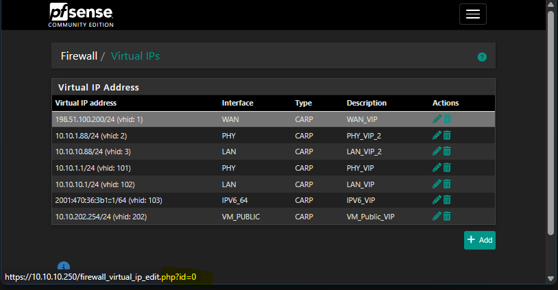

                                      zjamali @zjamali
                                      said in new if_pppoe Backend - getting HA/CARP to work like in MPD:
                                      @perrin
                                      is it because vipref == 0? my first vhid comes with id = 0
                                      Yup, that cause it. i changed to VHID LAN, id != 0, its appear in log
                                      • P Offline
                                        perrin @zjamali
                                        @zjamali great, thanks for figuring that out. I need to check why it's not working with vipref=0.
                                        currently i have no idea why this happens. vipref 0 is just the first item in the vips. config_get_path is a standard pfsense function.
                                        Maybe it is something with the way you configured that vip? is your first VIP configured differently ffrom the one you were using later?
                                        • zjamaliZ Offline
                                          zjamali @perrin
                                          @perrin Its the first vip configured in both pfsense node. So it gets id = 0.
                                          • P Offline

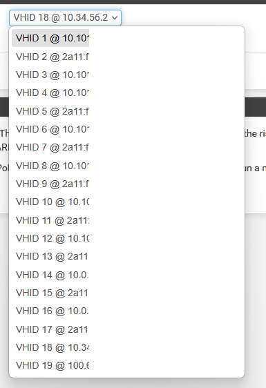

                                            perrin @zjamali
                                            @zjamali this is the way the dropdown in the PPPoE-HA GUI looks in my production firewall:
                                            in my case VHID 18 is the one that is configured for failover.
                                            Can you check if yours maybe starts with VHID 0?
