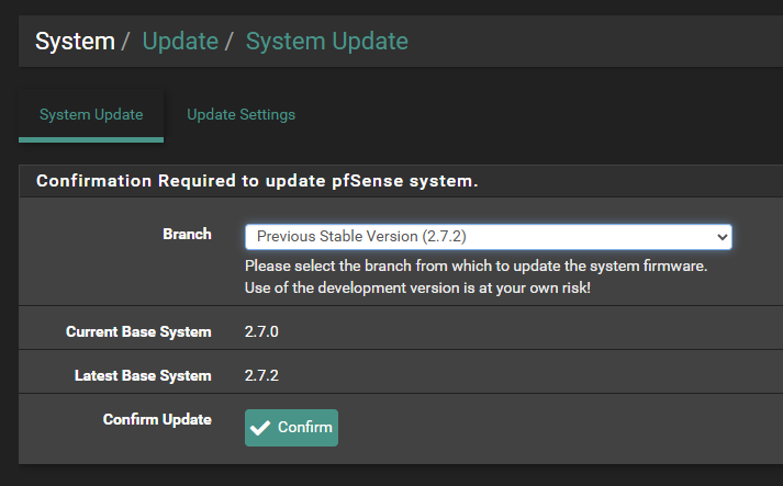

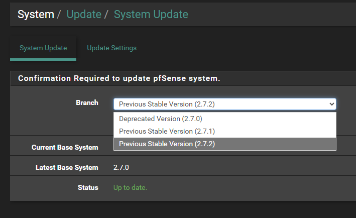

      I have had a search around but couldn't find the exact answer. Been using pfsense for many years. And updates appeared and rolled out flawlessly.
      My dashboard says
      And my update area show this.
      Question should I be running on 2.7.2? If so how do I go about initiating the upgrade or do I have to update to 2.7.1 first? Some advice would be great thanks. As I sy this has been seemless before and we have this little quirk.
      Advice appreciated thanks.
      this is community edition. yes it appears outdated I know. But it didn't raise an alarm for being out of date.
      Q\ Will running update from console at console pull the latest version automatically?
      S 2 Replies Last reply Reply Quote 0
        SteveITS Galactic Empire @zoqask
        @zoqask If offered there, you can skip versions.
        Also see https://docs.netgate.com/pfsense/en/latest/releases/2-7-1.html#troubleshooting

            Thanks for that so selecting 2.7.2 and running a console update should do the trick then by the sounds of it.
            I have an identical hardware box sitting in the corner. gave it a wan and it seemed to progress through the updates right up to 2.8 using the command console.
            finger crossed for this box although I can export the config over to this other box for test knowing it would actually upgrade is it should helps.
              Yup you can go straight to 2.7.2. Then you will see 2.8.0 and can upgrade to that. Or wait for 2.8.1 real-soon-now.

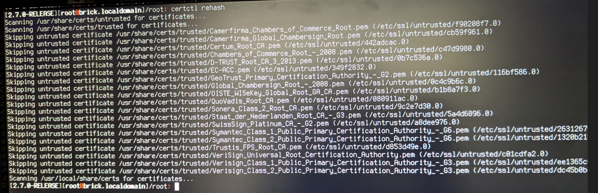

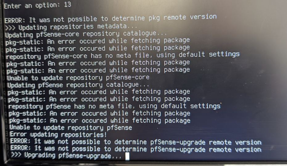

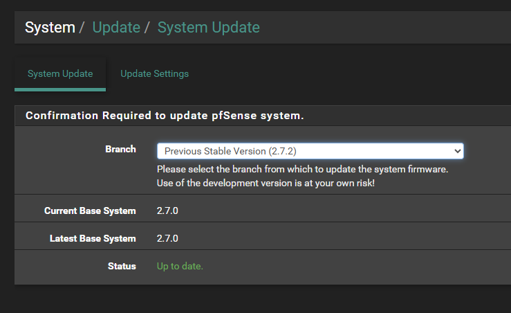

                I tried it from command line and I get this t then just exits.
                *Question* Any ideas what command I can run in the shell to pull the 2.7.2? Really not sure. For some reason I think the update has borked somewhere hence the lack of dashboard notifications.
                My gui settings are
                  Run at the command line: certctl rehash
                  Then try again.
                  • zoqaskZ Offline
                    zoqask
                    Thanks for that. In reality and from my screenshots previous what do you think has happened to cause this?. I know you don't have a crystal ball but identifying why these updates didn't register / notify would be good the know.
                      @zoqask Well per the link I posted above, "Due to changes in pkg, the new version of pkg may not be able to properly locate and use the CA trust store when running on the previous version before upgrading." A lot of (all) people had to run that command to be able to update.
                      Upvote 👍 helpful posts!

                          Yup it was a known bug in 2.7.0. It's fixed in 2.7.2 forward.
                          • zoqaskZ Offline
                            zoqask
                            Ran certctl rehash
                            I now get update request. So its a case of waiting for the right time out of hours now and trying it out.

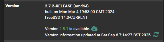

                                Morning all.
                                Well it updated to 2.7.2 and appears to all work. Thats good.

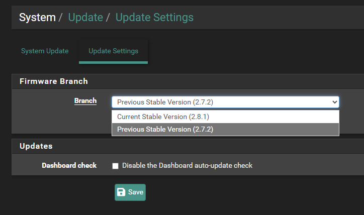

                                Do I have to re run the certctl rehash for 2.8? Reason I'm asking is is the dashboard said 2.8.1 is available but running 13 console update just says all the repositories are up to date and doesn't proceed with the upgrade.
                                After clicking the refresh icon on the dashboard I see this. But I always use the console and don't really feel comfortable with using the gui.
                                Do I have to select 2.8 from the stable branch here first?
                                Lots of questions but this is a major jump just doing due diligence.
                                • patient0P Offline
                                  patient0 @zoqask
                                  @zoqask said in Update Clarity:
                                  You don't have to run rehash again, no. But you will have select the 2.8.1 branch in the GUI, System / Update / System Update beforehand.

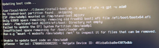

                                    I did the update and get this message at the end.
                                    Any idea if when I reboot the system will run? this may mean my temp files are taking up too much space. I just don't want to reboot and break the whole system for now.
                                    • patient0P Offline
                                      patient0 @zoqask
                                      I'm not sure, no. I'd say it's as it is written, the EFI partition has not enough space to update the boot loader.
                                      I would try what is suggested: mount the EFI partition and check for file you can delete (but not sure how to know what to delete). And search the forum for similar errors.
                                      Maybe @stephenw10 has an idea what can be delete from the EFI partition, and how to run to boot code upgrade again.
                                      zoqaskZ 1 Reply Last reply Reply Quote 0
                                      • zoqaskZ Offline
                                        zoqask @patient0
                                        @patient0 maybe Stephen has some ideas.
                                          @zoqask search the forum too, pretty sure I’ve seen discussions about that. Or just reinstall which will fix that and use the ZFS file system by default.
                                          https://docs.netgate.com/pfsense/en/latest/backup/restore-during-install.html
                                            It will probably boot with the old loader but I haven't tested that directly on CE. It's much more of an issue in arm64.
                                            But I would prepare to reinstall if you have to. It's unclear from that output whether it removed the old loader. It shouldn't if it can't update it.
