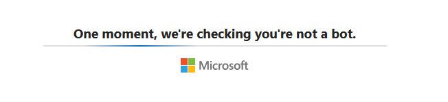

        johnpoz LAYER 8 Global Moderator @gadolf
        @gadolf I get this when I go there
        It sits there for a couple seconds and then I get a page where there is a login form.. Where you failing at the screen I saw, or after you try to login?

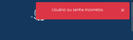

          Please, do the following:
          Enter 88454630791 and any password.
          Even with an invalid password it shows the Invalid reCaptcha error. (Probably you'll get an invalid username/password error, which means the recaptcha worked)
          This is my attempt with an invalid password. I didn't passed through the recaptcha so it didn't reach the credentials validation step
            @gadolf said in reCaptcha blocked?:
            88454630791
            yeah not seeing that - it flashes for a second, something pops up in the middle like a typical spinner.

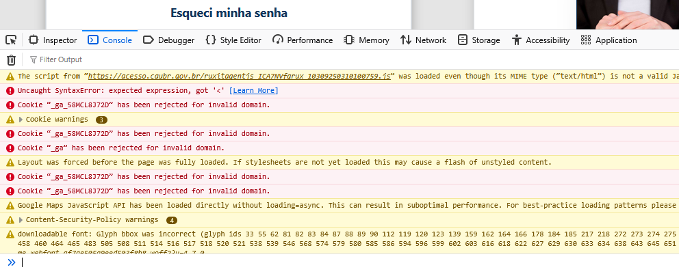

                    Other test methods : get a 'real' browser, and activate the web dev tools. That will show you what request are ok, which failed etc.
                    Like :
                    humm, looks like a typical government type of site - errors and warnings all over the place.
                    I also so
                    Visiting from France btw.

                      I also so
                      That's expected, and means that recaptcha worked for you and you didn't provided the right password.
