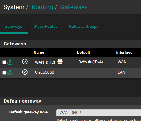

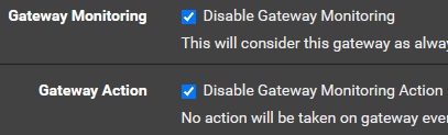

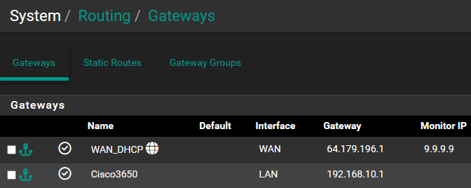

                • I Online
                  itsbry
                  Ok, so I see this:
                  So I did this for Cisco3650:
                    SteveITS Rebel Alliance @itsbry
                    @itsbry Cisco3650 shows as "LAN" interface, so why does it have a gateway set?
                    Upvote ๐Ÿ‘ helpful posts!

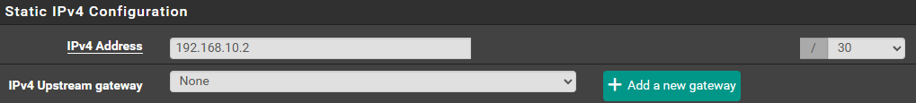

                      • stephenw10S Online
                        It's a downstream gateway on the LAN, that's fine when you have a router there.
                        The thing it should not be is set on the LAN directly. So in Interfaces > LAN, no gateway should be set. That's what pfSense uses to determine which interfaces are "WANs".
                        Either way it's clearly not a problem currently and not the cause of a WAN outage so no need to change that yet. It would be good to do so eventually to clean up the logs and diagnosing other issues easier.
