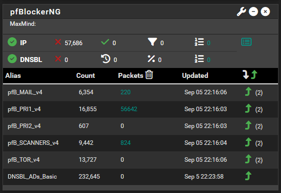

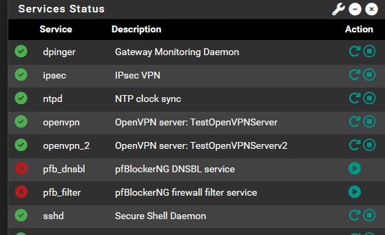

what does the pfblocker dashboard widget show ?
Same result (please see the 1st image)
@nanda said in pfb_filter and pfb_dnsbl services are not running Pfsense 25.07.1:
That's the services widget on the dashboard - not the pfblocker widget what does it show ?

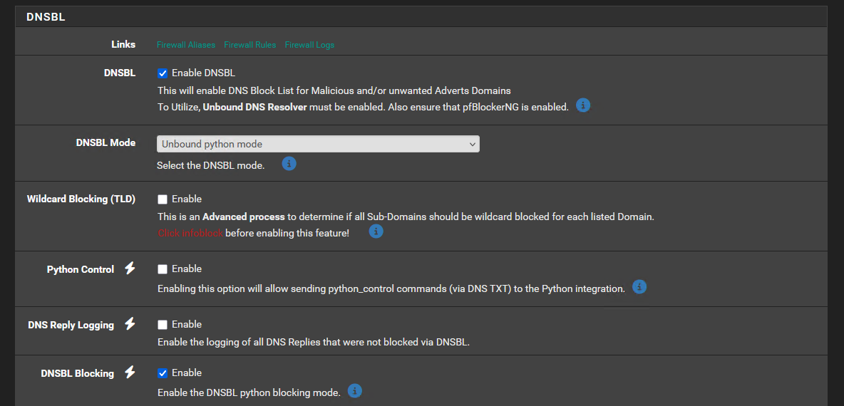

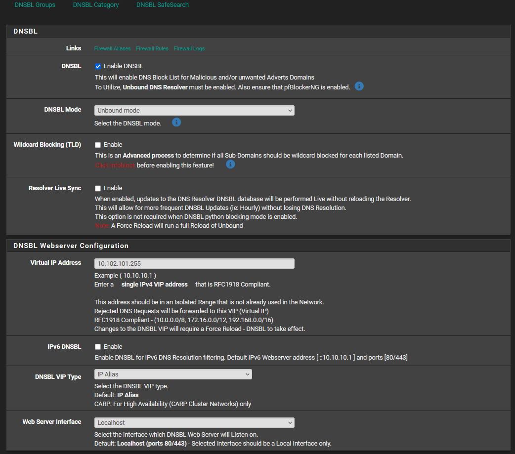

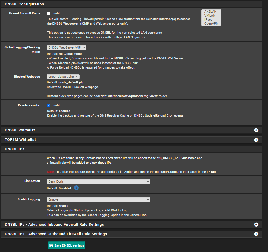

can you show us the dnsbl setup page python mode? and any other settings you may have - image of the settings page would be helpful

what blocking mode are you using ? DNSBL Web/VIP? Null block no logging? or null block (logging) ?
the certificate error might suggest you are using. DNSBL Web/VIP but let's confirm -

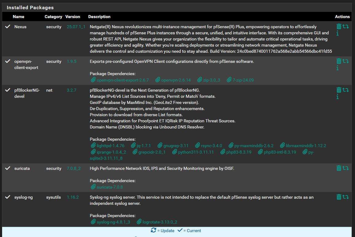

Have you got any packages installed that include openssl ?
what version is installed ?
openssl version -
Please see the screenshots below:
DNSBL Web/VIP
I do not see any installed packages, from given information, that include openssl. I think openssl is a necessity for pfsense functions, for example, certificate generation, and it will be a part of pfsense image.
[25.07.1-RELEASE][suser@...]/: openssl version OpenSSL 3.0.16 11 Feb 2025 (Library: OpenSSL 3.0.16 11 Feb 2025) -

that dashboard widget sort of says it is running (hasn't done anything (0 count) and are the services still down at that point ? usually when the services are down the check mark is what you see.

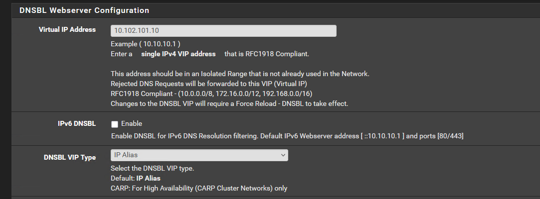

the Virtual IP address that end in .255 seems like a strange choice unless you have a very specific setup - is there a reason you picked that instead of the default ?

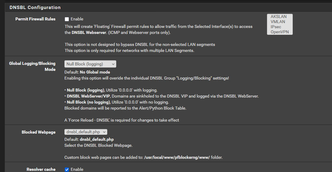

I'd be curious if you willing to try - if you turned off the DNSBL Webservice/VIP and used say Null Blocking (logging) - then see if the services start and stay running ?
Actually in my setup I have the "no global logging" option selected on that screen and then set Null Blocking (logging) on the individual selections -
The usage of specific IP address has no special reason. It is for convenience.
The configuration is changed as recommended.DNSBL mode => unbound python mode
Virtual ip address => 10.102.101.10
Global logging => Null blocking (logging)

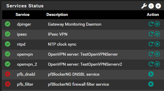

Services are not starting.
When I checked the status of the service, the firewall returned, "does not exist". I tried to find the executable in the directory, but I couldn't except sh file. Manual execution of sh files did neither produce executable nor start the service.

and yet it shows on the dashboard services widget..Please see below. I can see .sh files but not executables (suricata & syslog-ng have both).
