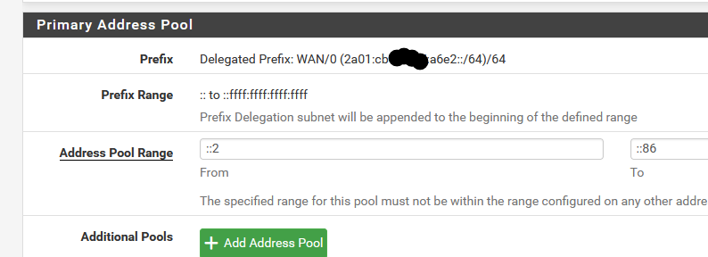

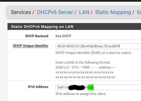

          Do you use DHCPv6 on your LAN(s) using dynmaic tracking ?
          Like :
          When you add "DHCPv6 Static Mappings", you have to add the prefix yourself, like :
          which is an issue of course, because the day your ISP decides to change your prefix, all your "DHCPv6 Static Mappings" entries are now wrong as the prefix was hard-coded (by yourself).
          If you leave "::cc" as is, then this invalid IPv6 will get added without prepending the current prefix, like the ":🅰30" in your case. And that's not good.

              axellarsson @Gertjan
              @Gertjan
              Yes, this is exactly what I do. Entering the suffix alone into the DHCP static reservation is supposed to be supported and works perfectly with ISC. Track Interface would be relatively useless without it.
              With Kea, this configuration still correctly assigns addresses as the complete IPv6 is expanded when pfsense generates the DHCP configuration. The problem is DNS, which now creates both an entry for the bare suffix as well as the expanded address.

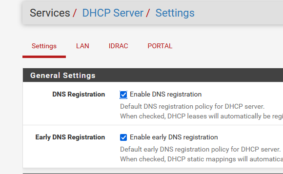

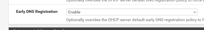

                In the case where you only want your static DHCP MAC DHCPv4 lease to be entered in the DNS, likewise before with ISC, it's this :
                and for every LAN type interface you select :
                and done.
