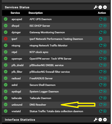

    After restart, Unbound DNS Resolver don't work

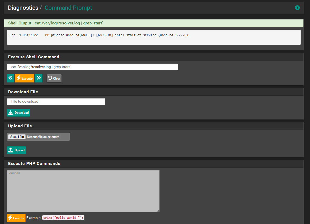

      This looks nice, but doesn't 'show' what needs to be seen.
      The command is good, though.
      So, use pfSense best interface : ssh or the console (menu option 8) :
      grep -E 'start|stop' /var/log/resolver.log
      This will only show when is stopped and started.
      Not if there was an error logged that could explain the 'why it stopped'.

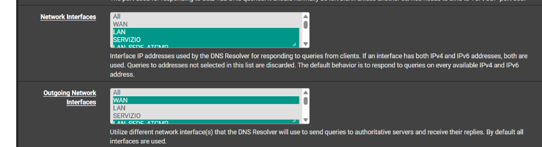

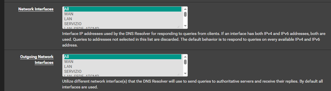

              Hello,

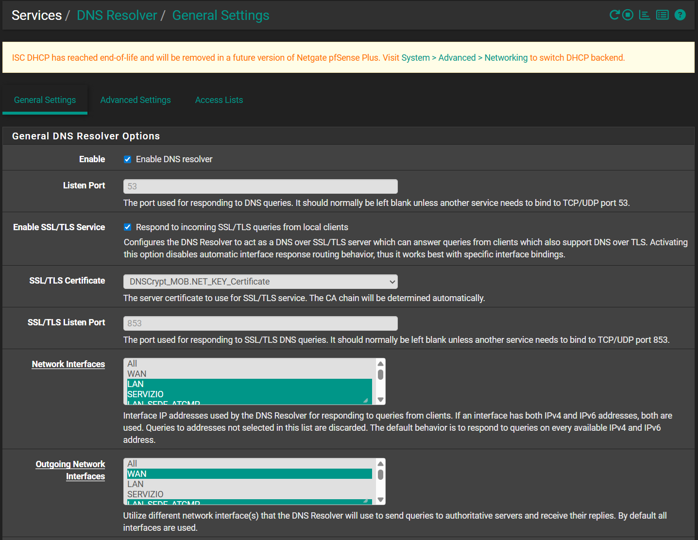

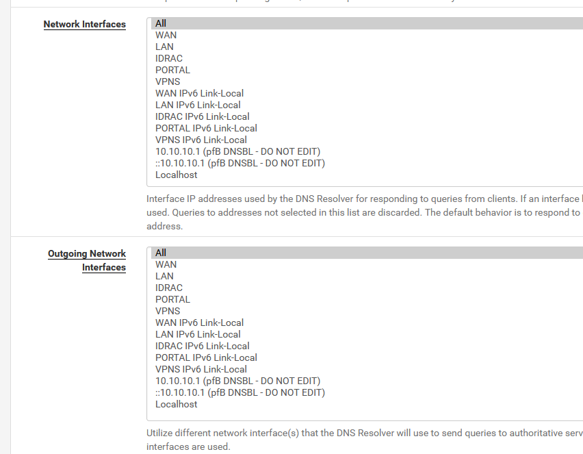

              i have change this config with ALLL and ALL:
              Before i have this configuration:
              I had read somewhere that under "Outgoing Network Interfaces" only WAN should be selected, and under "Network Interfaces" everything should be selected EXCEPT the WAN.
              Then, after trying various things, I also added "LAN_SEDE" to the "Outgoing" section. But the problem persisted. In addition to the WAN I had added the "LAN SEDE" where pfsense is connected
              Than:

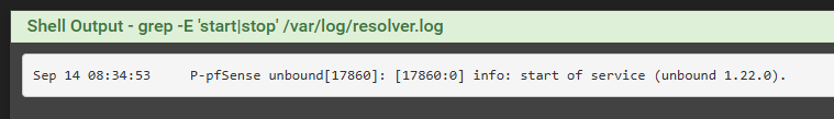

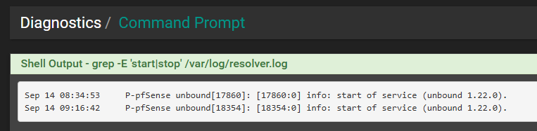

              Today 14 September 2025 at 08:32 i have restart pfsense.
              after reboot this time everything seems to work
              I just did another reboot and it's working fine
              It seems that the problem occurs when selecting items inside "network interface" or inside "outgoing network interfaces"

                Luca De Andreis @Unoptanio
                @Unoptanio
                I can confirm that my configuration does not have a default setting either.
                The interfaces are not configured in ALL:ALL mode and the problem occurs.

                    Yes, its true.
                    Setting ALL:ALL the DNS works correctly from system restart without manually restart daemon (after reboot) !
                    I've just tried now.
                    D C 2 Replies Last reply Reply Quote 1

                      This is a known issue which I reported a couple of years ago now. (Forum thread and also opened a redmine ticket that was not resolved)
                      It's to do with boot time sequencing of interfaces being brought up and services starting. Basically there are some race conditions in the boot up scripts that would need a significant redesign of the boot sequencing to fix properly...not an easy task on FreeBSD that lacks any kind of dependency based service scheduler and sequencer like systemd on Linux.
                      It can also happen if you have interfaces dynamically going up and down for example due to gateway groups.
                      The TL;DR is choose "All" for network interfaces for Unbound (DNS resolver) to cause it to bind to listen on all interfaces (even interfaces that don't exist yet when unbound starts) and instead use firewall rules to control access to the DNS server from networks/VLAN's that should not have access. (Put explicit block rules to port 53 on interfaces that you previously did not have bound)
