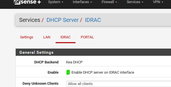

          Now, for example : I disabled the DHCP server (kea) for this interface :
          Save and Apply.

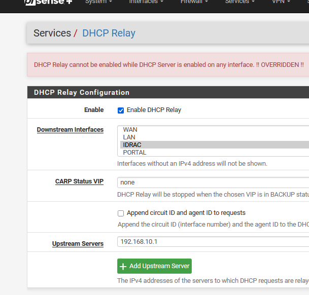

          Back to DHCP relay, select IDRAC - add a DHCP Relay server :
          and Save.

          root    56422   0.0  0.1  16812   4776  -  Is   11:10       0:00.00 /usr/local/sbin/dhcrelay -id igc2 -iu ix3 192.168.10.1
          The kea DHCPv4 is still running. If all goes well, it doesn't touch/use the igc2 - my "IDRAC" - interface.
          As you can see, dhcrelay is running also - using 'igc2' - my IDRAC interface.

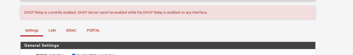

          You'll notice that on the DHCPv4 (kea, as that's what I'm using) there are also red messages showing.
          Also for the LAN, and other interfaces.
          I guess you know now how to make these GUI pages more "smart", and don't show messages if they are not needed.

          Also : I presume you cant' save DHCOPv4 ((kea) settings and network pages anymore, as on this pages the test 'is dhcp relay' running also exist (Generaol settings page : just the test, on the interface(s) page - the same PHP file is used for all interfaces the test also exist, and name some love).

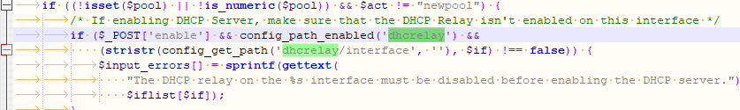

          Like : If you select an interface, like my IDRAC, that has a dhcp relay activated on it, show the red message and don't allow the user to Enable it with an active DHCP server. This is now already the case. Make the code a bit smarter by testing the (this) interface is used by dhcp relay, and only allow the DHCP server (kea) to be activated on that interface if it is not used by dhcp relay.
          See /usr/local/www/services_dhcp.php- here :
          how to make these decisions.
