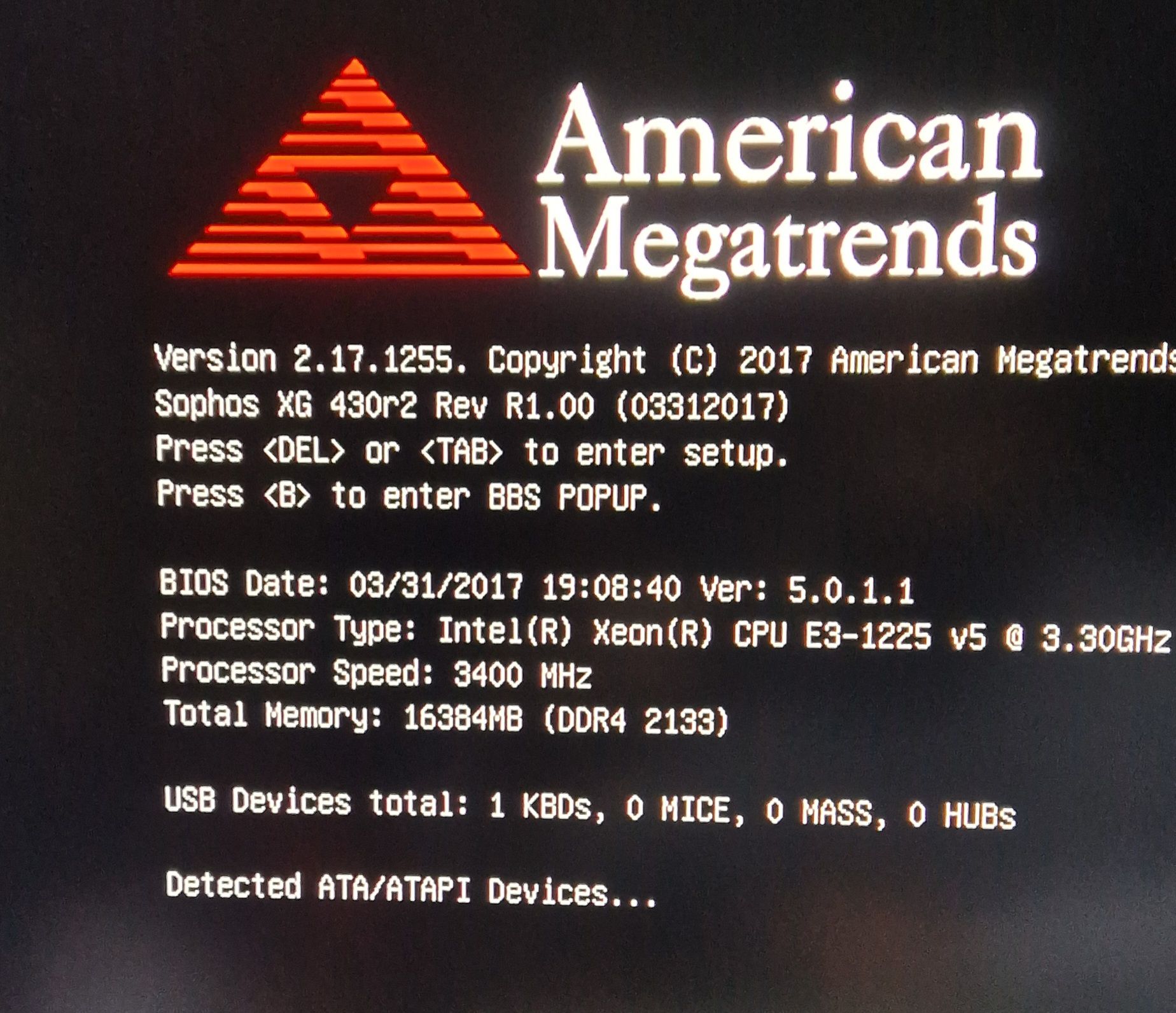

        @RM-0 can you post a screenshot of the error you got. That may tell us something already.
        And do you have specs for it, CPU, RAM, disks and what NICs are built-in?

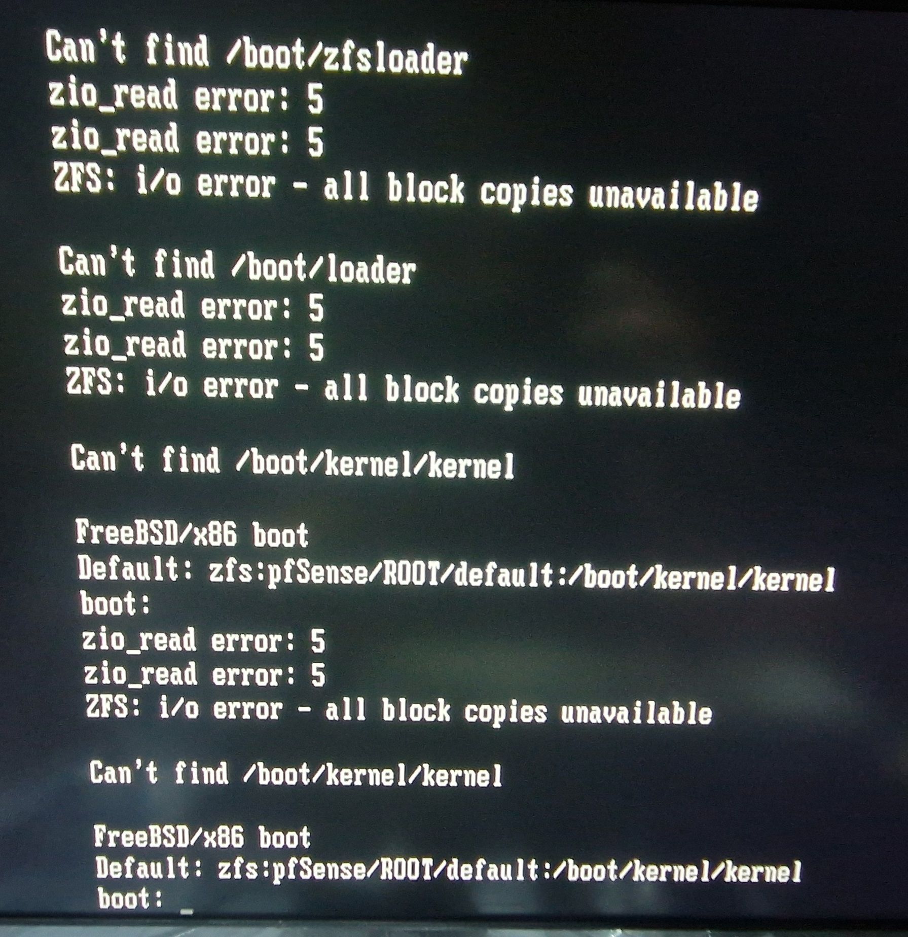

          This is the error and the hardware
          I am now wondering if there is a problem with the SSD as I powered the firewall back up and it slowly booted all the way to the pfsense then I rebooted and got the error again.
          The only additional NIC's added was the 10G SFP flexi port module which works fine in the other sophos sg450 that I have.

            @RM-0 mmh, if it stalls at boot: that does indeed look like the issue where you would have to disable "Port 60/40 emulation" (according to the internet).
            Can you switch from UEFI to legacy in the BIOS?
            If you don't have the option to disable the "Port 60/40 emulation" in the BIOS (Advanced menu > USB Configuration > Disable “Port 60/40 emulation”) then it may be not possible to run FreeBSD based OS's.
            On an other thread Pfsense on Sophos XG450 rev2? a user asked if pfSense would work on it but did not report back. Maybe you can contact him here on the forum to see if he was able to get it working?

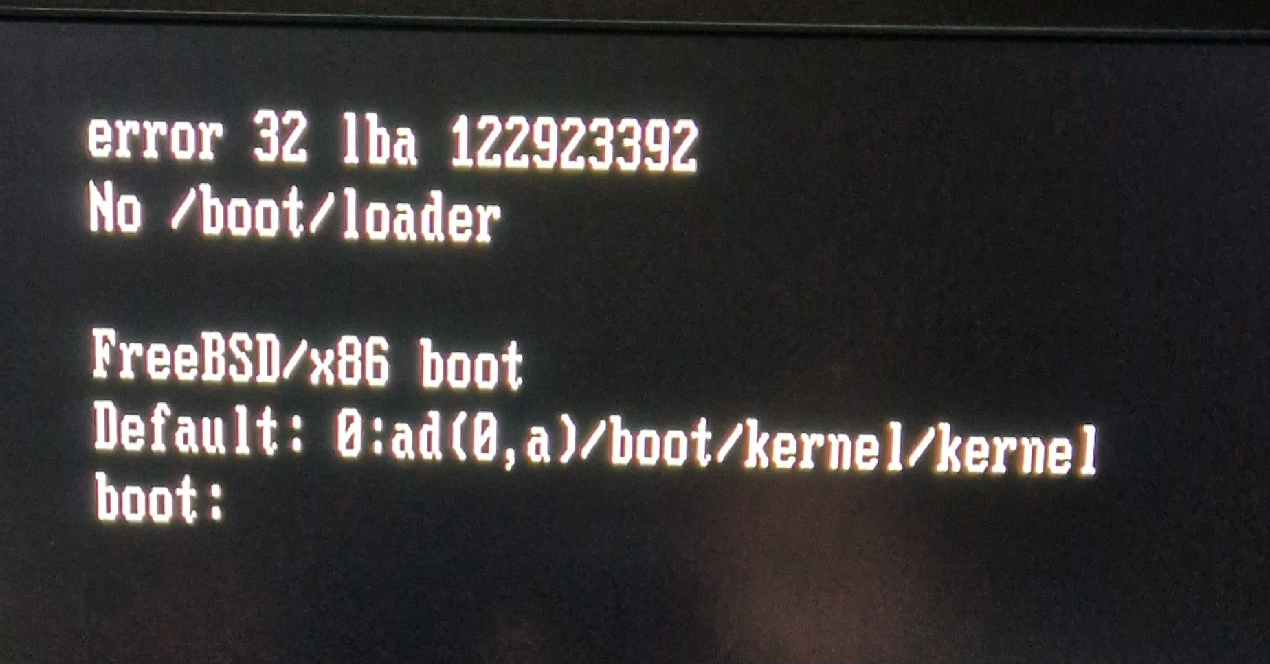

              @patient0 I switched it to legacy then did a fresh install using auto ZFS.
              Then went to the Shell at the end of the install and did the the kern.vty thing i was instructed to and rebooted the pfsense.
              Got the following errors this time and when I showed it to Gemini it confirmed that my SSD is failing.
                RM 0 @patient0
                @patient0 thanks very much for the help, it turned out to be that it was the SSD that was the issue. I switched it out to a 128gb SSD then did a fresh install and it booted straight away after the install without any issues.
