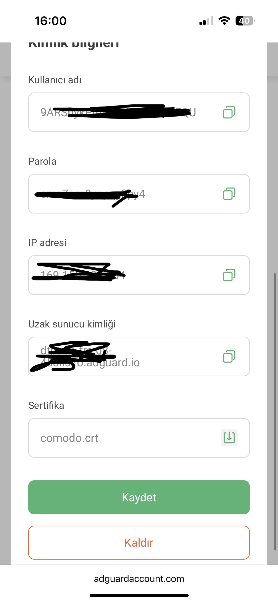

Hello, ı would like to connect Adguard vpn from pfsense as client. But ı couldn’t make it work. How should I use infos below on pfsense ?

@umtsti I have no experience with it but since you got no answer: have you read
https://adguard-vpn.com/en/router/overview.html?
Set up your router - In your admin page, go to the router settings - Enable VPN Client and click Add VPN server - Select IPsec/IKEV2 - Enter the credentials you created in step 2 - Connect devices to your router
It seems to be a IPsec/IKEV2 VPN and the following link explains the pfSense IPsec/IKEV2 setup:
https://docs.netgate.com/pfsense/en/latest/recipes/ipsec-mobile-ikev2-eap-mschapv2.html
Addition: the link above is for pfSense as IPsec server. pfSense as IPsec IKEV2 client is probably more of an issue/maybe not possible. Search the internet for "pfsense as IKEv2 client" and you'll find some posts which state that it doesn't work if you need user/password authentication. Only in a site-to-site VPN setup.
@patient0 non il semble impossible de faire cela, le paquet pour linux semble incompatible avec freebsd. je crois bien que le service ne sera pas compatible du tout. le support de wireguard semble être la seule solution mais elle n'arrivera pas de si tôt vu que c'est annoncé depuis très longtemps sans avoir évolué
