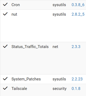

      But if I close webconfing and come back, the error returns... Any ideas? I see here on the forums a few others are having a similar error, but mine doesn't seem to be quite the same.
      My installed packages are as follows:

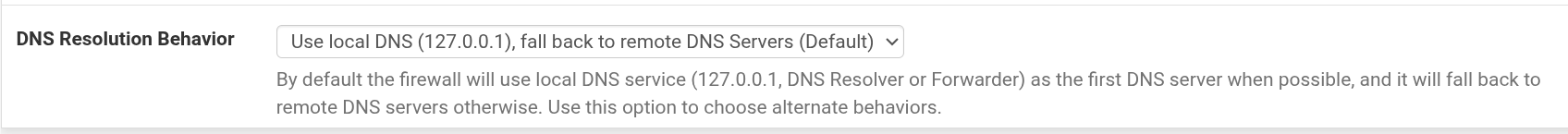

        What WAN type do you have? How is your DNS configured?

          My WAN type is IPv4 DHCP.
          DNS config:
          I have around 20 DNS IP's in General Setup. It's never been an issue before.

            Hmm, that second output is correct.
            Do you have Unbound running in the default config locally?
            What do you see if you try to resolve pfsense.org in Diag > DNS Lookup? How many servers? Are they all responding?
            • RahzadanR Offline
              Rahzadan
              Thanks. It turns out a number of the IPs in my DNS servers were no longer responding. Problem solved :)
