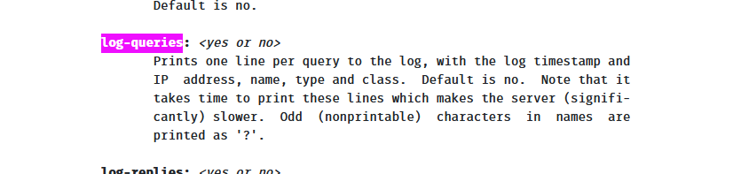

          This is from the author : latest version :
          https://nlnetlabs.nl/documentation/unbound/unbound.conf/ :

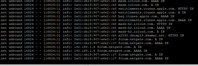

          When adding "log-queries: yes" : like :
          and then the Apply at the top of the screen, my log got hail-stormed with :
          My advise : don't leave this config option in place longer then strictly needed.
