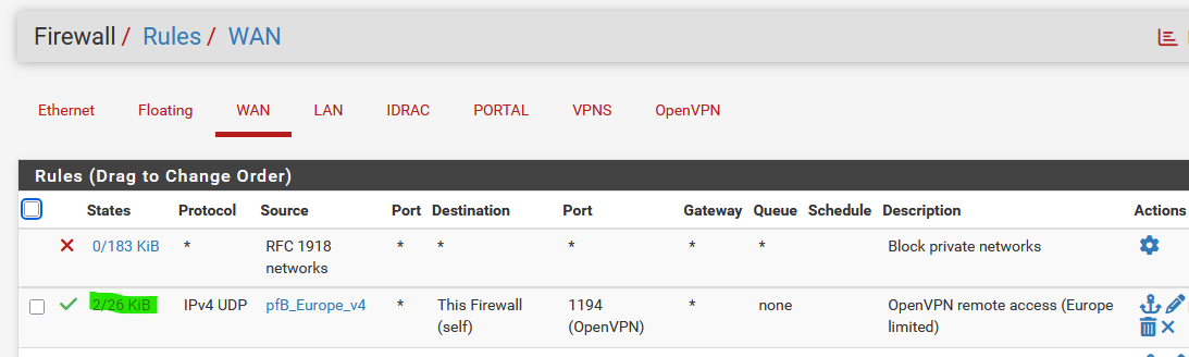

        I use the pfSense VPN server.
        It listens on the pfSense WAN interface, port 1194, UDP.
        So I created this pfSense WAN firewall rule :
        the rule matches traffic, see the green marked indication.
        I have, like you, an upstream ISP router, so I has to NAT on this router port 1194 UDP to the WAN IP of pfSense.
        Be ware : I only needed this "pass" firewall rule, which is not part of a NAT rule, as the destination of the VPN traffic is my pfSense, not some device on my LAN.

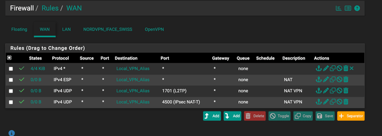

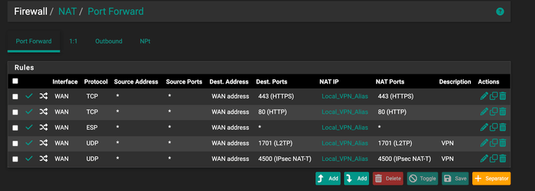

          The VPN i have issue with is a separate instance, behind PFsense that worked before PFsense. This means i know my ISP allows port forwarding, i simply changed the IP from my VPN in the PF rules to the PFsenseIP (as my VPN was now behind PFsenseo on a new IP).
          As stated - Port forwards are set (192.168.1.2) <- WAN IP of my PFSENSE.
          I also added 192.168.1.2 as DMZ on my ISP router!
          Then i have a NAT setup listening for, the HTTPS/HTTP forwarding is working for web traffix to the web server on the same VPN instance.
          I have also a VPN CLIENT on the PFsense box that is routing specific MAC client to Swiss break out. i mention this as i just want to be sure it is not a cause of any issues.

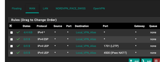

            This :
            the first firewall rule, the one that says : 4/4KiB, that is a firewall rule not being part of a NAT rule ? Right ?
            Something tells me that that rule 'gobs' all incoming IPv4 and sends it to ... black hole ?
            Your IPv4 ESP doesn't mention a port ... maybe ESP doesn't needs port (like ICMP) - I can't tell.
              alexanderjh @Gertjan
              @Gertjan
              ah yes i move this one top or bottom , just trying to "catch everything" as you say but it didn't work i should delete it.

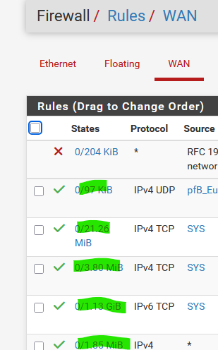

                        @alexanderjh said in Issue with local Ubuntu VPN behind PFsense:
                        I really struggle to see where issue is.
                        The very first thing I test when dealing with NAT rules : I set them up, then de de-activate the wifi on my phone, and connect to the "ISP WAN IP" using a browser, VPN client or RDP tool and check here :
                        where I can see the firewall rule in question receives traffic = the counters start to raise = the rule is actually used.
                        If these stay 0/0 then you have a solid proof that your traffic isn't reaching the pfSense WAN interface.
