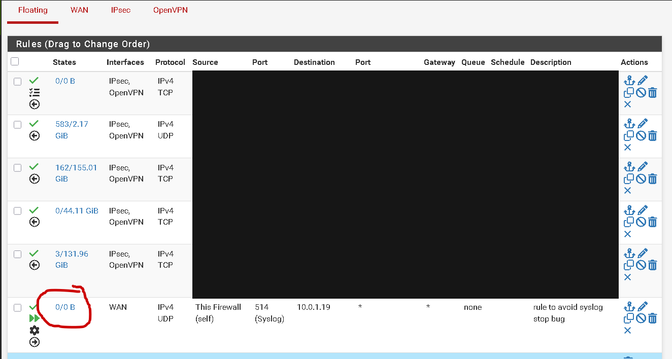

            geovaneg
            Apparently the rule isn't working because the traffic counters aren't incrementing. There's a "let out anything IPv4 from firewall host itself" rule with higher precedence that seems to be capturing UDP traffic to the remote syslog server, even though the new rule is of the "floating" type.
            @28 pass out inet all flags S/SA keep state (if-bound) allow-opts label "let out anything IPv4 from firewall host itself" ridentifier 1000003613
            @46 pass quick inet proto udp from (self:3) to 10.0.1.19 no state label "USER_RULE: rule to avoid syslog stop bug" label "id:1762800608" ridentifier 1762800608
            Geovane

              • G Offline
                geovaneg
                This is a VPN server located in the DMZ... It has no LAN interface, only a WAN and IPSEC interface, and the counters are not incrementing despite continuous traffic to the log server.
                I might be forgetting something obvious, but I reviewed the settings and tested it more than twice.
                Geovane

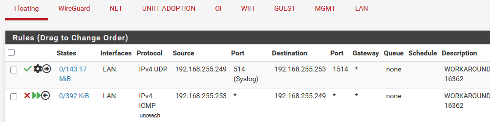

                    Looks like you might have the source port set to 514 instead of the destination.
                    In your first screenshot it's not shown as an OUT rule also but it looks like you corrected that.
