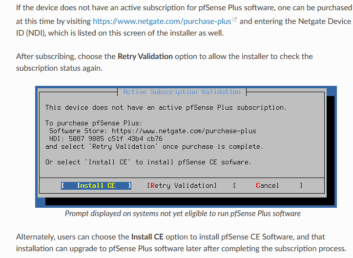

        https://docs.netgate.com/pfsense/en/latest/install/install-walkthrough.html
        Scroll downwards.
        You should find :
        Btw : I never used the installer app myself.

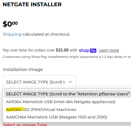

          the only "purchase" choice for a memstick image is "Netgate appliance".
          You aren't shown the other options?
          image:
          Or if you're asking which to use, you can burn the ISO to a USB stick.
          https://docs.netgate.com/pfsense/en/latest/install/prepare-installer-media.html
