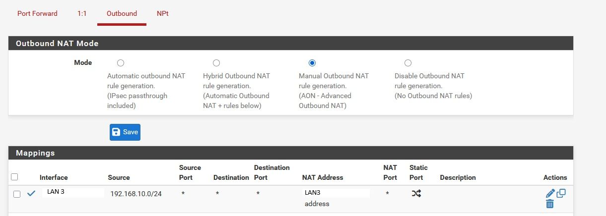

      When I configure NAT outbound rule for 192.168.10.0/24 to use y.y.y.81 as addess in Translation section leaving WAN as interface the hosts from 192.168.10.0/24 are still visible in internet as x.x.x.102
      When I change interface to LAN3 in NAT outboun rule it stop works at all.

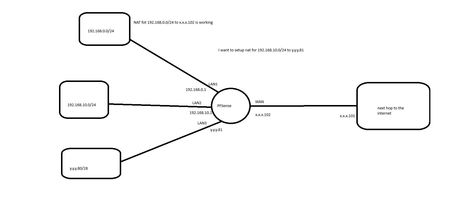

          LAN3 is a LAN interface because this is a different public network /28 routed to my router to his WAN IP x.x.x.102. This network is y.y.y.80/28 where y.y.y.81 is gateway for this network but from LAN3 side. In my understanding this is LAN network but with public IPs. It's not connected directly to the internet link. It's on the oposite side of the router, but is accesible from the internet as the second public IP of the router but on the different interface than WAN.
          I hope that I can explain it as much clearly as I can :)
          Ind the question is.. do I use IP of this "inside" interface as NAT source to the internet for 192.168.10.0/24 network whis is connected to another LAN interface.
          When I try to setup it as on the screen any of the internet IPs are not pingable. Rules for LAN 2 and LAN 3 allowa any outgoing traffic.
          Is any chance to make it working?
          Maybe this diagram explain more:
          Best regards and sorry for my not very fluent English :)
          Paweł

              Yes, i know this. Hosts from y.y.y.80/28 can directly reach internet through routing (without NATing of course). I have no NAT outbound rules for public network.
              The case is to use the second public IP of the router from LAN3 interface to NAT through it hosts from LAN2 network (192.168.10.0/24).
              Please see my diagram :)
              I want a situation that:
              192.168.0.0/24 is NATed through x.x.x.102
              192.168.10.0/24 is NATed through y.y.y.81
              y.y.y.80/28 is routed without NAT
              I'm preety sure that i dit it a long time ago on linux.
              BR
              Pawel
                    You can nat the source IP to any you want. But you have to define the outbound NAT rule on the WAN interface, because this is the one, the traffic is going out.
                    Just edit the rule and change the interface to WAN. Done.

                      @viragomann thanks for your reply.
                      It doesn't work that way. I mean it does, but I access the internet with the address x.x.x.102. It's important that the address I want to NAT to (y.y.y.81) is not on the WAN interface, but on LAN3.
                      x.x.x.102 is the single IP on WAN interface.

                        So I guss, the NAT address changed to the WAN address.
                        Set it to LAN3 address and it should do, what you want.
