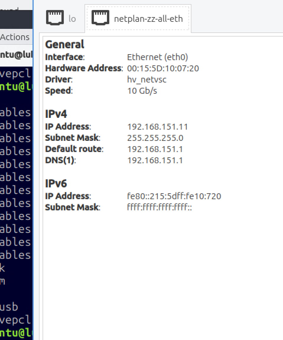

      Hello everyone!
      It just doesn't want to go online... ;-((

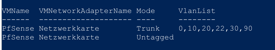

      The following configuration (HyperV-VM, VLAN-Trunking)
      VLAN-ID 22 to OPT1 with the subnet 192.168.151.0/24

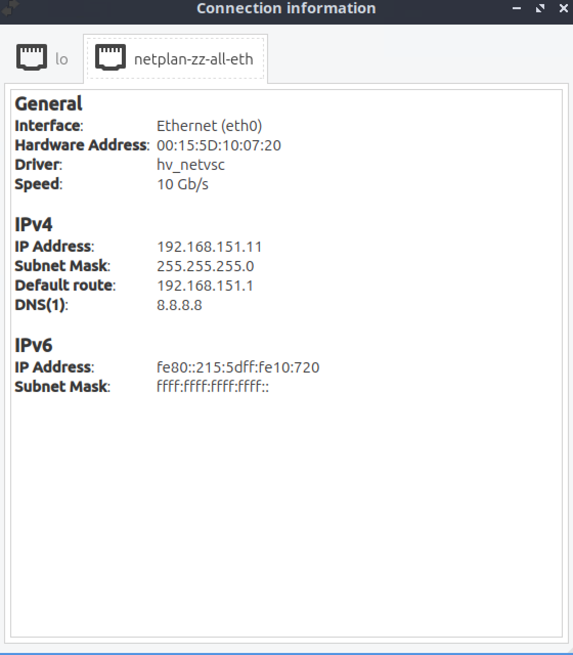

      The two machines connected to VLAN 22 also receive the correct addresses from the IP pool via DHCP. However, both have no internet access. The ping on the address 192.168.151.1 also fails.
      Maybe one of you has an idea or solution.
      cheers

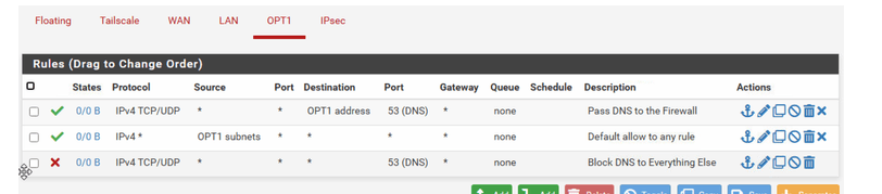

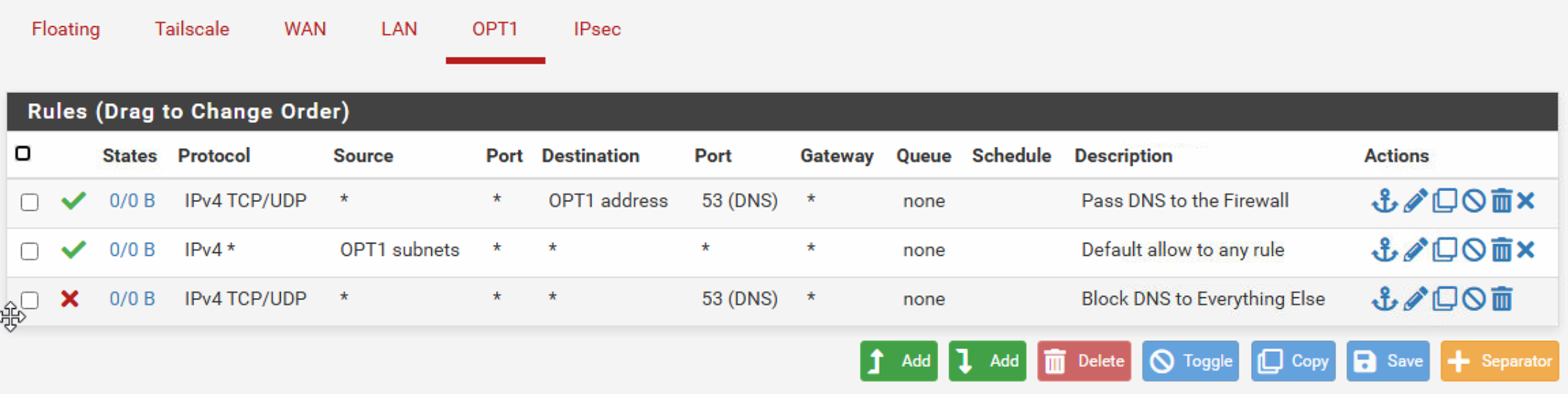

        The rules look fine :
        Looking closer :
        shows that no traffic what so ever ever reached this OPT1 interface.
        My suggestion : Review your VLAN setup.
        Btw : Only allowing port 53 = DNS traffic to reach the pfSense Interface = 192.168.151.1 and block all other DNS traffic, AND handing over by DHCP the 8.8.8.8 DNS IP is ... counterproductive.
        The device will probably use 8.8.8.8 for its DNS needs and your pfSense will not allow (block) this.
        J 2 Replies Last reply Reply Quote 0

          Alright, many thanks for the tip. The only thing that comes to mind is that the Pfsense must be restarted after the "Trunking" has been permitted.
          cheers

                          Never ever believe the "system". As the network admin, at all times, fact check everything ๐Ÿ˜Š
                          For example, red flags were already shown : The IP (192.168.151.11) looks ok. Mask and gateway also. But the 8.8.8.8 DNS is a fail.
                          So, my thoughts : some one set them up statically ? Or entered 'strange' settings in the DHCP server ?
                            jogovogo @Gertjan
                            @Gertjan
                            The 8.8.8.8 is only for testing; even if I use the machine to set the IP and as a DNS and gate, the 192.168.151.1 does not work.

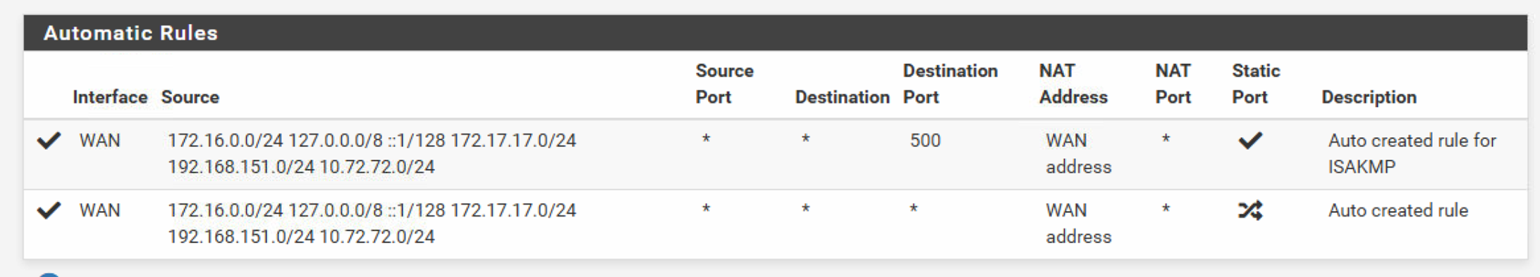

                                NAT and VLAN
                                The port 2413 should be seen on 192.168.151.10. The corresponding rule is created automatically. Unfortunately, it does not function.
                                The "LAN " operates it without any intervention.

                                    This is working now as well. We used pfBlockerNG, and the opt1 still needed to be defined in the Outbound Firewall Rules. Then once update via cron and now it works!

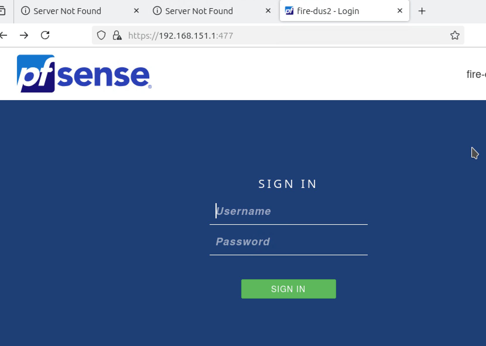

                                      @jogovogo said in No Internet access with VLAN via OPT1:
                                      My first surprise is that I'm now on the firewall, but why?
                                      The web server that serves the pfSense GUI runs on all assigned interfaces.
                                      When you installed pfSense, there was a pass rule for incoming traffic on the initial LAN interface : it accepts all traffic.
                                      When you add more LAN type interfaces, the ones called OPTx, there will be no inital rules, so you can't access anything.
                                      DHCP will work as pfSense will add hidden DHCP (UDP port 67 and 68) rules, but nothing else (no http https dns icmp etc etc etc etc).
                                      When you add a pas rules for TCP, UDP, etc, things "start to work".
                                      When you use addresses like this :
                                      you use IP addresses.
                                      So, even is DNS is not working, then that won't be an issue.
                                      Your browser doesn't need to use use DNS (for translating host names to IP addresses) as you already gave an IP. It can contact the device 192.168.151.1 right away.
                                      You've allowed TCP IPv4 traffic to port 477, which is apparently your changed your pfSense https web GUI interface port.
