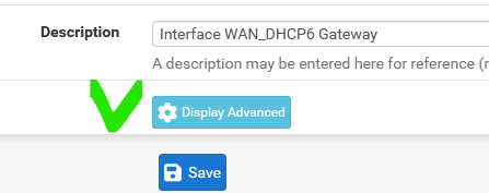

        Have a look at what this button hides :
        where you can set up : how much, after what delay, what type of packet etc etc.

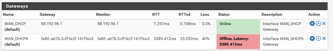

          Gateway monitor wont disable ipv6 like i would like. My windows computer behind firewall still uses ipv6 as default and its very laggy because of packet loss. While ipv4 works fine.

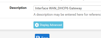

                      Go here : System > Routing > Gateways > Edit, on the bottom of the page click on :
                      and there you can fine control the monitoring 'ping' settings.
