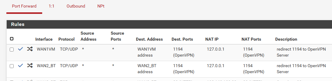

        Configure openvpn to tisten on localhost.
        Create a portforward in both WANs, from the Internet (any), to 127.0.0.1 port 1194 UDP.
        Use DDNS or configure two remote entries in the .ovpn, with a timeout of 2 seconds.

                The suggestion above by @mcury is the easiest method. It also means routes configured for VPN clients still apply regardless of which WAN they connect via.
                In the .ovpn client file, you simply have two remote entries:
                remote [WAN-1 Public IP Address] 1194 udp4
                remote [WAN-2 Public IP Address] 1194 udp4
                Pete

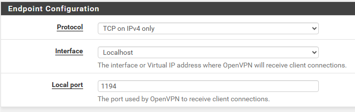

                      In my case the single VPN server listens on Localhost. Then there's two port-forwards (one for each WAN) to the same VPN server.
