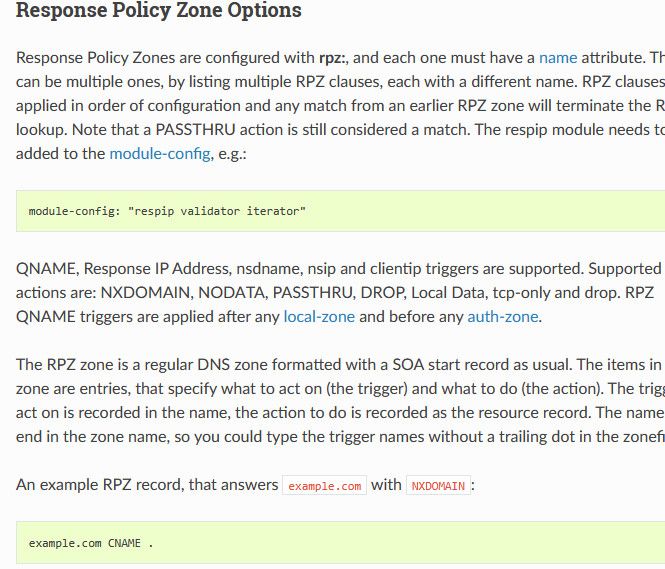

              johnpoz LAYER 8 Global Moderator @jg3
              @jg3 Not sure how you think a Response Policy Zone (RPZ) solves what your looking for?

                You're missing my question. I'm not looking for an RPZ (I don't know where RPZ entered the chat), I'm looking to be able to create a CNAME.
                  @jg3 said in Why not a CNAME?:
                  that is what you linked too.
                  I realize pfSense relies on Unbound as upstream, but it looks* like this feature is supported.
                  You can for sure create a cname - but that cname that points to X fqdn, can not magically point to now Y fqdn.
                  If you have a host that changes its name/ip - what you should look for is just a ddns that changes the ddns name you want to point to this new IP.
                  Not sure why zerod in on cnames - other than cnames are a way to point to a different fqdn that you might not control what IP that fqdn points to. But I am not aware of anyway to dynamically change what fqdn a cname record points to other than via a API into the dns.. Or maybe you could script something with unbound-control.
