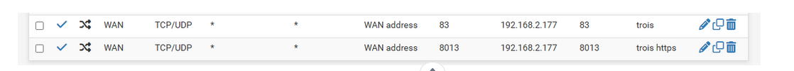

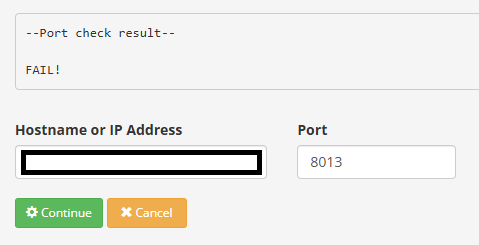

      Hi, after i use dyno and let's encrypt for my SSL, i try to add new ports to open but when i check using port checker all the new ports cannot be open, but all the old ports is still open,
      i try to use the old port and change the IP, then i access the website on public, but when i try to add new ports. it was closed.

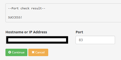

      sample:
      port 83 is old port (before i use secure SSL)
      port 8013 is new port ( after i use secure SSL )
      did anyone experience this problem ?
      thank you.
        johnpoz LAYER 8 Global Moderator @ipcam.starinc
        @ipcam.starinc well that checker does is send a syn.. If it gets no syn,ack back then yeah it would fail. So 192.168.2.177 isn't listening on port 8013 or it has a firewall not allowing traffic too that port.

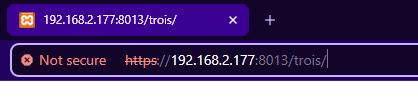

          @johnpoz i can access it on local network. 8013

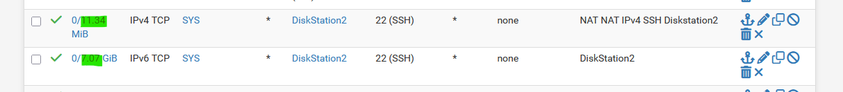

            shows the NAT rule. Each NAT rule has an associated firewall rule. You will find them on the WAN interface. These firewal rules have matching packet counters ( !!) in front them.
            If these counters start to raise, you know they were 'used' (== matched) and traffic entered the WAN interface using that rule.
            So : what do these counters show you ?
            Does your TCP port 8013 traffic even reached pfSense ?
            Example : some of my WAN NAT Firewall rules :
            The first shows the good old IPv4 : 11+ Mbytes of traffic.
            The second shows the incoming IPv6 traffic for the same device : 7+ GBytes of traffic.

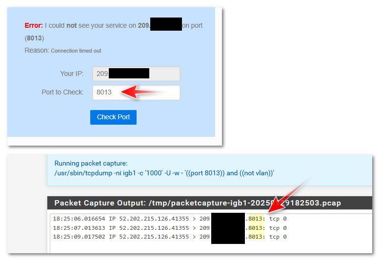

                      @ipcam.starinc well troubleshoot the problem - first thing in any port forwarding is to validate the traffic actually gets to your wan.
                      Go to like can you see me and send traffic on port X
                      Do you see the traffic? If not then something in front of pfsense is blocking it, and no your never going to get a port forward to work.
                      Lets take your original example.. Can you see me . org
                      It is a 2 second check, but necessary because if you can not see this traffic on your edge - there is no possible way you could ever get it to something inside your firewall.
                      I have no port fowards for this, I do not listen on that port on pfsense, etc. etc.. But none of that is needed to validate the traffic is actually being seen by pfsense. Just a simple packet capture.
                      If you see this traffic - then setup sniff on the pfsense interface used to send the traffic - do you see it being sent, do you see a state being created? If not then you have something in pfsense firewalls blocking it, or do not have your port forward setup that evaluates the seen traffic correctly to be sent.
                      If you see pfsense send it out the proper interface to get to where you are fowarding and you get no answer then the problem is down stream of pfsense.
                      It should take no more than a couple of minutes to figure out where the issue is.
