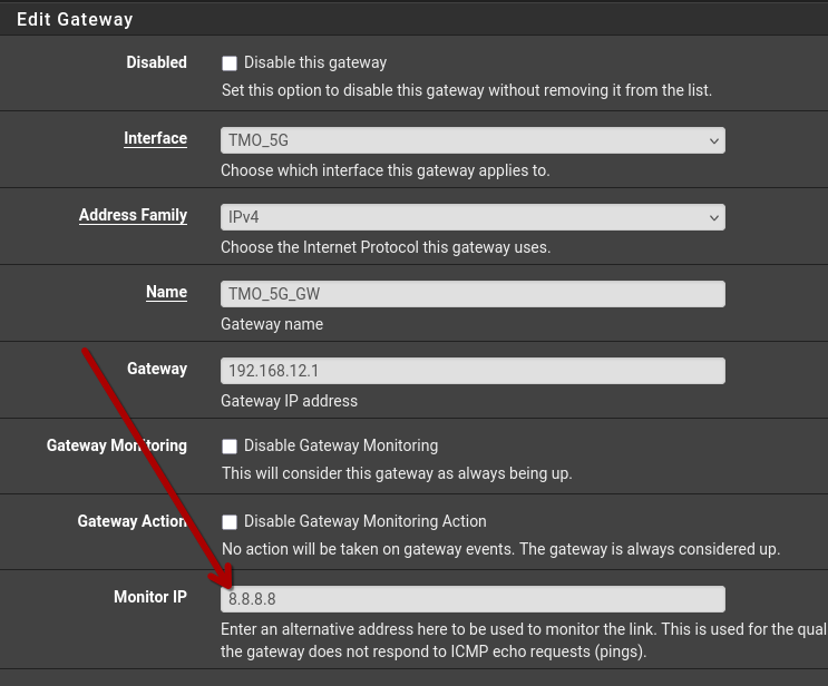

        Did you set monitoring IP under Routes WAN2 gateway?
        • K Offline
          KB8DOA @w0w
          @w0w
          Yes I did:
          Bob.DigB 1 Reply Last reply Reply Quote 1

                  Hi @KB8DOA - From the screenshot you posted above, I assume you have T-Mobile 5G Home Internet running on WAN2? If so, I ran into similar issues recently. Under Advanced settings for your WAN2 gateway, try increasing the Data Payload parameter from the default value of 1. For T-Mobile Home Internet I believe 4 was the minimum value that worked for me, but you can choose a larger size as well. This is likely also the reason that regular pings succeeded through Diagnostics/Ping as these ping probes use 56 bytes of data by default vs. dpinger's 1.
                  https://docs.netgate.com/pfsense/en/latest/routing/gateway-configure.html#advanced-gateway-settings
                  Hope this helps.
