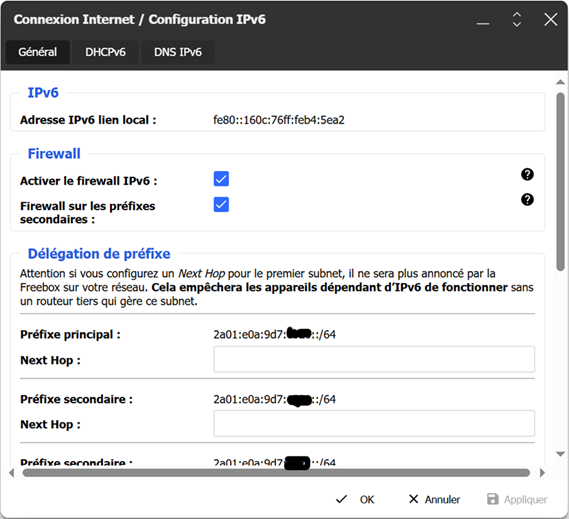

      My ISP offer fixed IPv4 and ICMPv6 /64
      In my case I have IPv4 82.64.90.xxx /32 and 2102:E0A:9D7:xxx/64
      I turn off the routed mode and I turn ON bridged mode.
