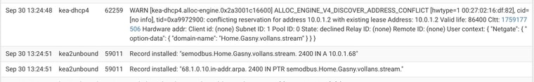

      I’ve got a weird problem and can’t swap over to KEA for DHCP. My settings for one of my devices are really quite simple:
      If I use ISC DHCP it works every time
      If I change to KEA, my solar inverter ALWAYS gets an address from the pool rather than the statically allocated IP address, breaking my MODBUS links in Home Assistant.
      Any ideas how to fix this?

        kea thinks ( ? 😊 ) that 10.0.1.2 is already leased out to some other device (?).
        10.0.1.2 doesn't show up under Status > DHCP Leases ?
        Can you ping to 10.0.1.2 (= someone is already using it) ?
        pfSense told kea to keep a copy of its memory (attributed leases) here : /var/lib/kea/dhcp4.leases

            It does - for the solaredge inverter. It even shows the same MAC address. I can't ping 10.0.1.2 because that is the inverter, and it's been given another IP address. It's doing my head in!

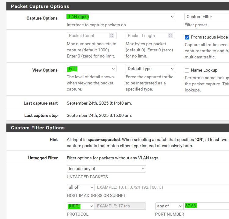

                before you switch back to DHCP : go here : Diagnostics > Packet Capture
                and tell it what you want : DHCP details :
                This will show you all the DHCP traffic on your lAN : the device requests, the pfSense DHCP server answers;
                By the MAC, you will recognize what packets came from, and are send to the solaredge.
                Remember : kea says it found a ".....V4_DISCOVER_ADDRESS_CONFLICT" so the device asking for "10.0.1.2" was refused that IP as another device already uses it.
                Check the already IPv4 allocated leases again.
                Check the packet capturing - byte by byte and check what kea received, and had already stored.

                        @Vollans : can you get a DHCP packet capture of the exchange between your Solar and pfSense ?
                        If kea says : "can't give 10.0.1.2" to Solar because some other device is already using it " then this isn't a Solar neither kea bug. Btw : a DHCP will ARP (?) or ping the requested IP first, to check if some device on the LAN isn't already using it. If a ICMP reply comes back, then it will show this message.
                        I propose a test :
                        Disconnect all LAN devices.
                        Power down the Solar (or remove Ethernet connection).
                        Stop the kea DHCPv4 server.
                        Remove all leases on pfSense (brut force by wiping the leases file).
                        Start kea.
                        Start packet capturing as shown above.
                        Connect the Solar.
                        Now, "V4_DISCOVER_ADDRESS_CONFLICT" can't be possible anymore.

                            Anyway : I still suspect it isn't a kea issue as it clearly says : 10.0.1.2 can be given as another device is using it.
                            Afaik, kea does a network network broadcast for "who has 10.0.1.2") first and no device should answer. Apparently, some one answered.
                            What about an ARP packet capture to see who answers ?

                                  If it (== 00:27:02:16:df:82) was renewing, meaning it was/is already using 10.0.1.2 and it just wants to renew (extend) the lease, then kea would hand over a renewed lease.
                                  Your issue happens after a DHCP DISCOVER, where the Solaredge doesn't have an IP (previous lease) yet.
                                  Whe kea does its ARP test, it (the solar edge) won't say it has that IP (10.0.1.2) as it wasn't allocated to it yet. Some other device did answer the 'who has 10.0.1.2' ARP request.
                                  It couldn't/shouldn't be the Soladeredge (and if it did, it's DHCP stack is broken).
                                  https://lists.isc.org/pipermail/kea-users/2017-November/001399.html and follow ups.

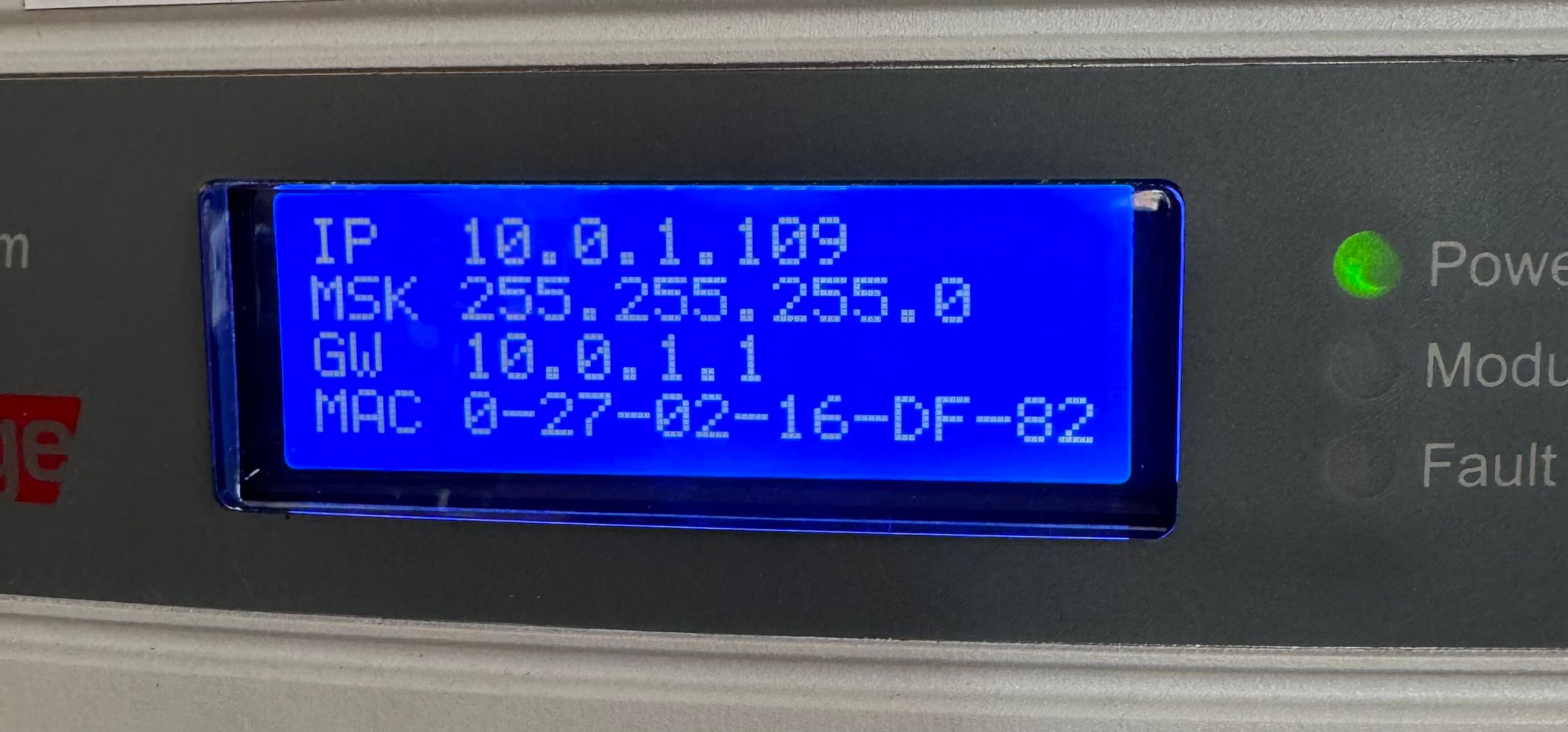

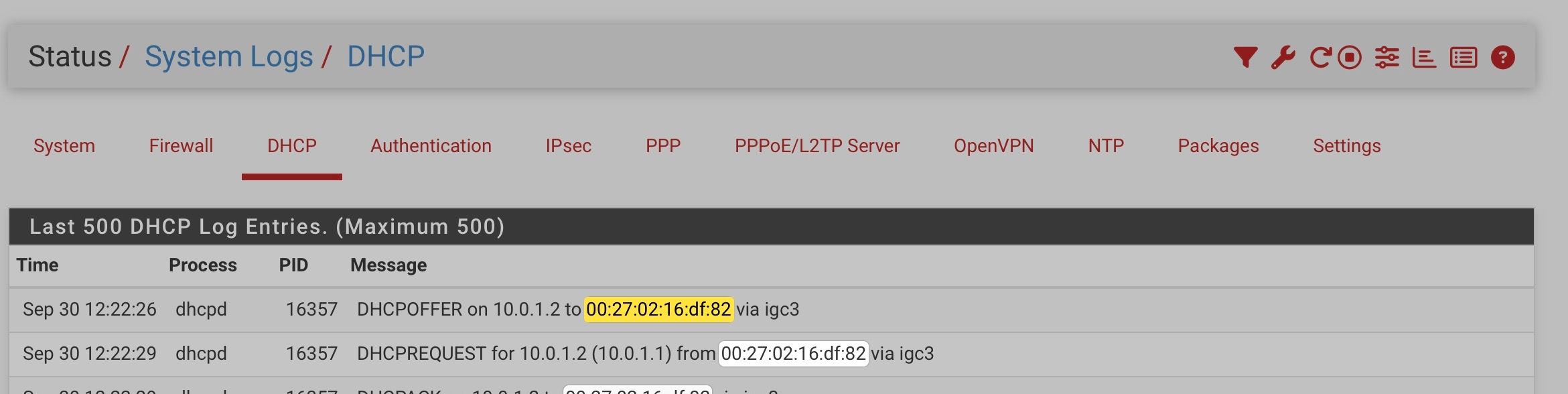

                                    @Gertjan Hmm. It’s bloody odd. Friday I tried again, and it did get allocated 10.0.1.2. Hurrah. 9am this morning, with no network downtime or anything, it suddenly decided it was getting 10.0.1.68…
                                    I think at this stage I need to stay on the ISC version until I can find time to try and fix the IP address in the Solaredge inverter using the video you linked to.
