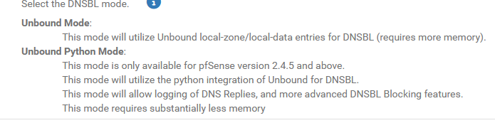

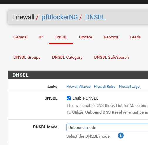

                      When pfBlockerng is set like this :
                      it will assemble all DNSBL files together, and place the result into one big /var/unbound/pfb_dnsbl.conf, where unbound reads the file upon process start.
                      This worked well in the past., when the Internet was one big happy place with very view 'sites' (host names) to block. Then came the 'everyone wanted to be there' moment, and a lot of pure 'BS' sites were created. The ones you don't want to access. This list became bigger huge.
                      You can continue to use this mode, but do read this :
                      first.
                      Then read a couple of these : kea2unbound.
                      and know you understand why I told you to switch to Python mode ๐Ÿ˜Š
                      When a huge text file is read in by unbound at start, it could take minutes before it had parsed the entire file. during all this time, DNS is down.
                      Python mode offers a faster way to access the 'list' with all the blocked DNSBL entries, and allowing unbound to start faster if a restart was needed.
                      Python mode offers also more details to report (more graphs ans stats).
                      When switching to Python mode, the line "server:include:/var/unbound/pfb_dnsbl*.conf" will normally disappear. If it doesn't, no big deal. Just check if there are no "pfb_dnsbl*.conf" files anymore in /var/unbound/. If there are none, you can remove the line yourself.
