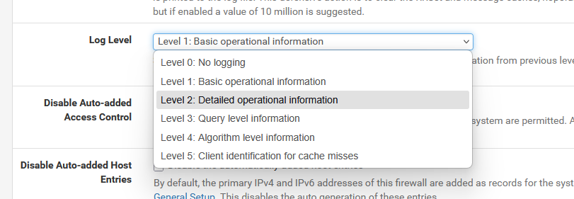

          If you want that unbound tells you more about what it is doing, you can ask it to do so.
          For example :
          Be ware : this new log should be a temporary settings as higher log levels produce more logs lines. For example, the query level produces log line for every incoming (from pfSense, or one of your LANs) DNS request.
