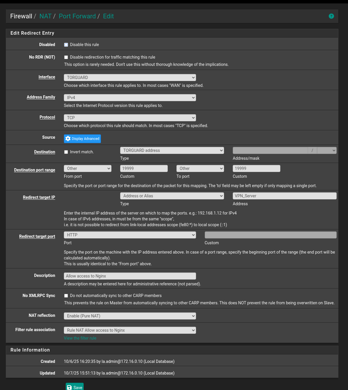

      I've tried to NAT the port directly:
      So the rule looks like this

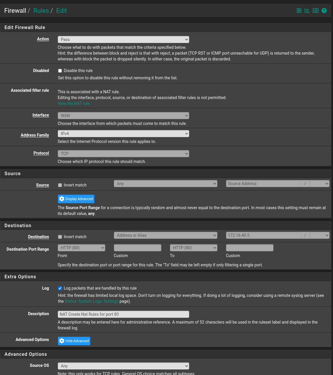

      Edit the newly created Rule on torguard interface

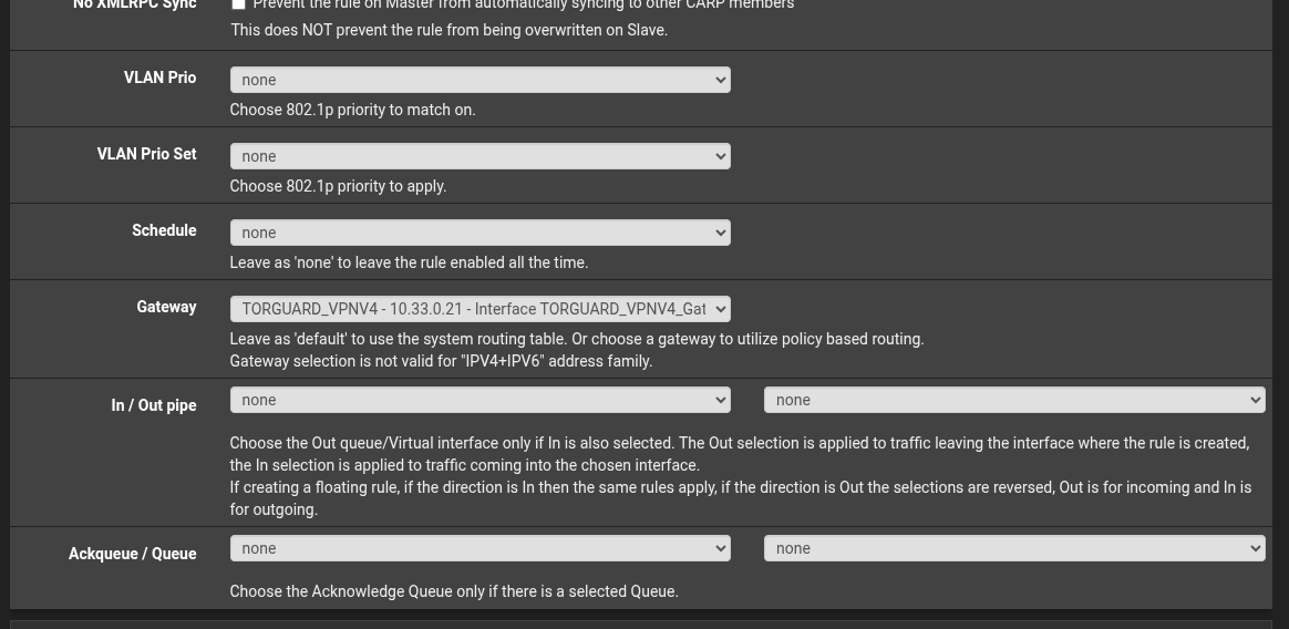

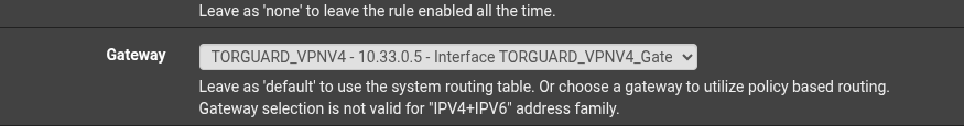

      Changed the Gateway under advanced setting for the Rules
      So the RUle under the Torguard Interface looks like this
      But as the picture shows - I'm just not getting any trafic through this nat - trying the address: http://22.22.22.22:19999 is just not reachable, and the rule does not show any traffic.
      I've tried creating the rules without NAT, creating it in firewall rules only the same issue remains. I can not get trough on the port - and still not seeing any traffic goes through - neither way. This is the setup - only with a rule created for the interface torguard.

        @Udbytossen said in Portforword through a VPN client:
        This screenshot show that the rule is on the WAN interface, which would be wrong.
        This is nonsense. The Torguard gateway is the VPN server. So why want you redirect traffic coming from the VPN server back to it?

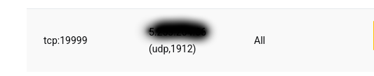

          That are given - so to speak - I Can forward port int the provider Interface - where I created a rule for port TCP:19999 - and the provider says they are effective.

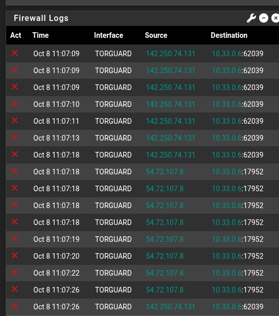

          Allthough I can see traffic are beeing drop by the firewall - but can not see the traffic comes through

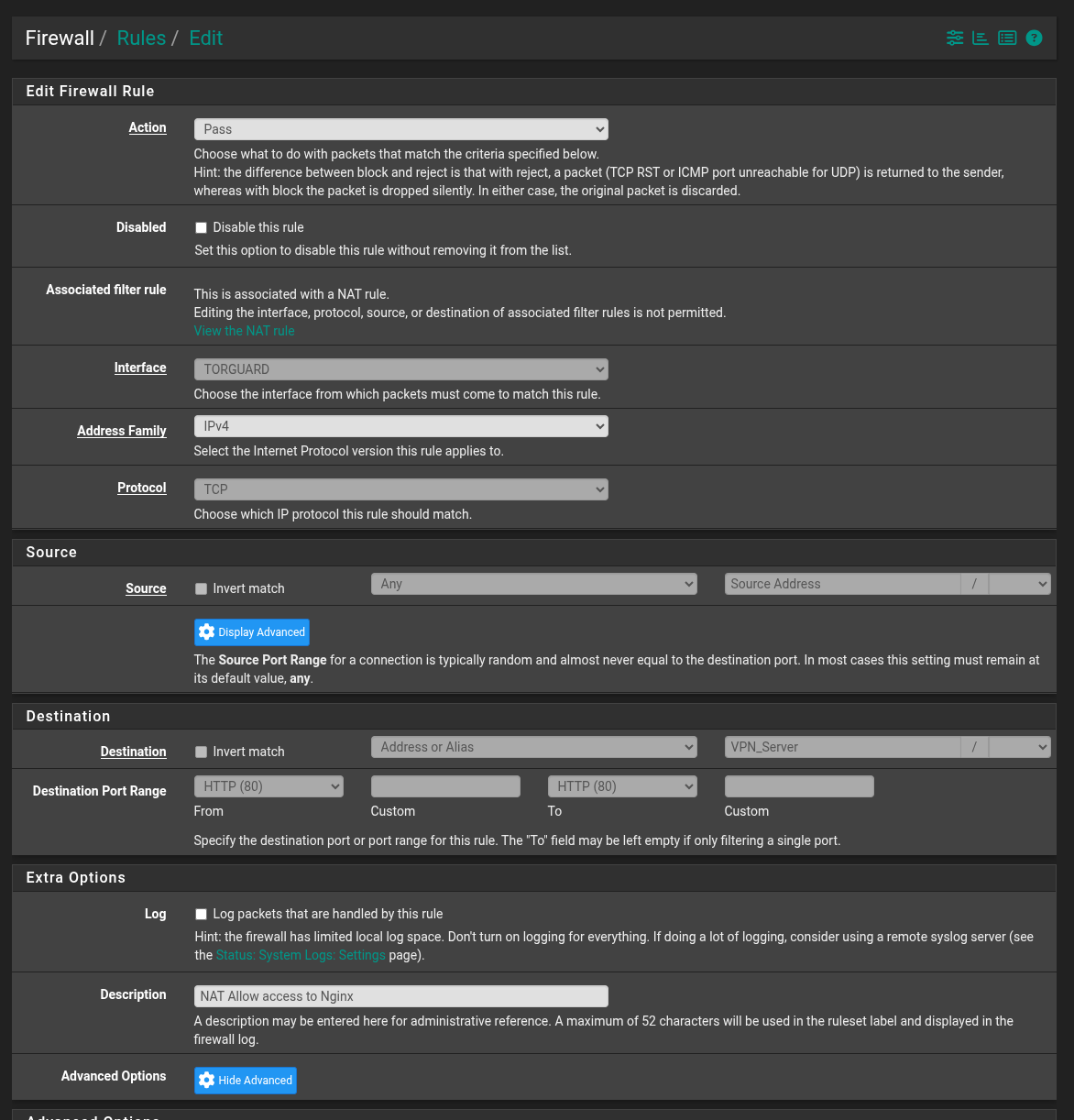

          The correct screenshot of the firewall rulesa. Under Advanced is the gateway also set to torguard - so the right screenshot of the created NAT andautomatically created firewall rule, is these 20
          And under the firewall rule advanced setting I'm changing the gateway to Torguard instead of default
            But already mentioned, that this makes no sense at all. So edit the rule and set the gateway to default.
            Then go to the OpenVPN rule tab and remove or disable each pass rule.
            Done.
