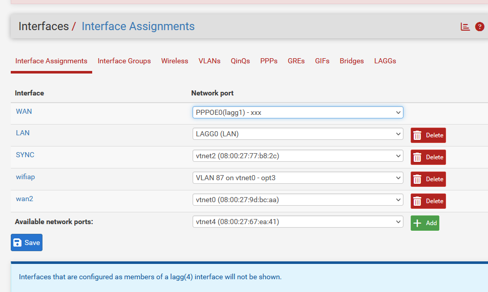

                    I can provide replicated VM config.xml if you’re still interested. This needs 5 free ports on any hardware, I think and you need to manually edit interfaces before applying it.

                        In case you are installing in the VM just import the machine into the Virtualbox, and install 2.8.1, then apply configuration.

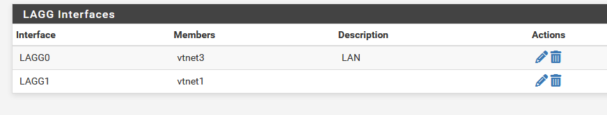

                        lagg0: flags=1008843<UP,BROADCAST,RUNNING,SIMPLEX,MULTICAST,LOWER_UP> metric 0 mtu 1500
                        	description: LAN
                        	options=4800bb<RXCSUM,TXCSUM,VLAN_MTU,VLAN_HWTAGGING,JUMBO_MTU,VLAN_HWCSUM,LINKSTATE,TXCSUM_IPV6>
                        	ether 08:00:27:42:e3:96
                        	hwaddr 00:00:00:00:00:00
                        	inet 192.168.1.1 netmask 0xffffff00 broadcast 192.168.1.255
                        	inet6 fe80::a00:27ff:fe42:e396%lagg0 prefixlen 64 scopeid 0xa
                        	inet6 fe80::1:1%lagg0 prefixlen 64 scopeid 0xa
                        	laggproto failover lagghash l2,l3,l4
                        	laggport: vtnet3 flags=5<MASTER,ACTIVE>
                        	groups: lagg
                        	media: Ethernet autoselect
                        	status: active
                        lagg1: flags=1008843<UP,BROADCAST,RUNNING,SIMPLEX,MULTICAST,LOWER_UP> metric 0 mtu 1500
                        	ether 08:00:27:f9:2b:76
                        	inet6 fe80::a00:27ff:fef9:2b76%lagg1 prefixlen 64 scopeid 0xb
                        	laggport: vtnet1 flags=5<MASTER,ACTIVE>
                        	groups: lagg
                        	status: active

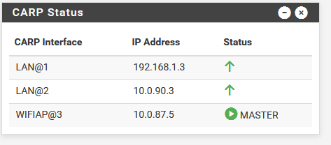

                        vtnet0.87: flags=1008943<UP,BROADCAST,RUNNING,PROMISC,SIMPLEX,MULTICAST,LOWER_UP> metric 0 mtu 1500
                        	description: wifiap
                        	options=80000<LINKSTATE>
                        	ether 08:00:27:9d:bc:aa
                        	inet 10.0.87.2 netmask 0xffffff00 broadcast 10.0.87.255
                        	inet 10.0.87.5 netmask 0xffffff00 broadcast 10.0.87.255 vhid 3
                        	inet6 fe80::a00:27ff:fe9d:bcaa%vtnet0.87 prefixlen 64 scopeid 0xc
                        	inet6 fe80::1:1%vtnet0.87 prefixlen 64 scopeid 0xc
                        	groups: vlan
                        	carp: MASTER vhid 3 advbase 1 advskew 254
                        	      peer 224.0.0.18 peer6 ff02::12
                        	vlan: 87 vlanproto: 802.1q vlanpcp: 0 parent interface: vtnet0
                        	media: Ethernet autoselect (10Gbase-T <full-duplex>)
                        	status: active
