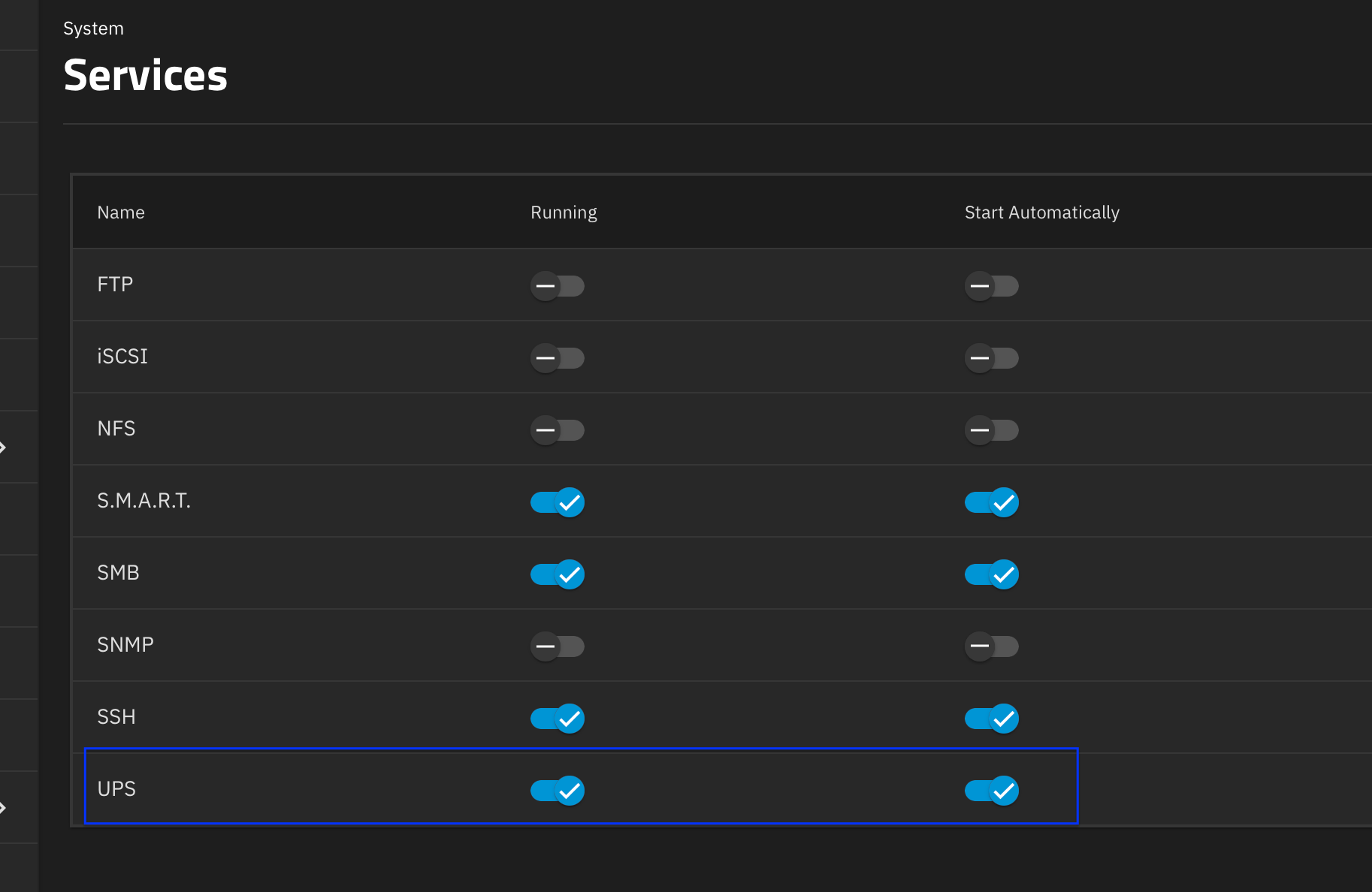

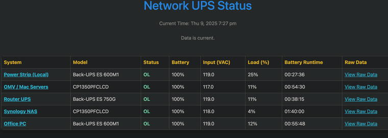

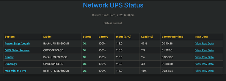

                                @dennypage I managed to create a docker container with some "custom" programming to work! here are some screen shots:
                                johnpozJ dennypageD 2 Replies Last reply Reply Quote 2
                                  johnpoz LAYER 8 Global Moderator @netboy
                                  @netboy do you have this docker available - this is actually pretty slick.
                                  I didn't think about monitoring the one connected to my nas.. It monitors it for shutdown of the nas, but it be nice to see such info off of it. I have one behind my tv I monitor with pi I have connected, that is my ntp server as well. I keep meaning to put another pi I have for the one in my av cab to monitor that one - just haven't gotten around to it.
                                  I have 4 total in the house of the cyberpower ones.. Be nice to throw them all into 1 place to monitor.. One I monitor on my pc, with misc network gear plugged into that, one my nas monitors for its own use, pretty sure the pfsense is on that ups along with my APs I think - but didn't think of turning on its server function and point pfsense to it.
                                  You have inspired me to to a better job of monitoring mine.. Mine are all cyber power 1500s, would have to double check models but I know at least 2 of them are the cCP1500PFCLCD
                                  I think your docker would be perfect for my use as well.
