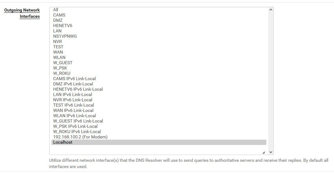

          johnpoz LAYER 8 Global Moderator @martinez
          @martinez I always set my unbound to use loopback as its outgoing.. If you can not talk to ipv4 with unbound bound to your interface?
          So your pfsense behind a nat.,. its wan IP is 10.153? Or you bound it to the lan interface for some strange reason??
          I bind to the localhost, because it should just use your normal routing that way. But try binding it to all.
          If bound to localhost, when system starts or if you have issues with your wan for example unbound can start and bind to the interface even if wan is not yet up, etc.
            martinez @johnpoz
            @johnpoz It's good to know for the loopback (I will find out more).
            Yes, (unfortunately) I am behind a NAT from the access provider and the address 10.153 bound to my WAN interface.
            I set the binding to All and rebooted, then localhost, with both configurations the problem remained unchanged

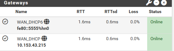

                martinez @johnpoz
                @johnpoz I just ran the test, and... I only get outgoing DNS traffic in IPv6 (with the ipv6 in alias below)
                So I'm wondering if the problem somewhere :
                Since I didn't receive IPv6 with DHCP, I used "virtual IP" to assign a public address on the WAN interface. However, I have outgoing DNS traffic with IPv6 defined as an alias, but no outgoing traffic with 10.153.
                However, if I use a resolver internal to the LAN, I do get SNAT and outgoing traffic (and the correct responses).
                I feel like I'm not doing this correctly ?
