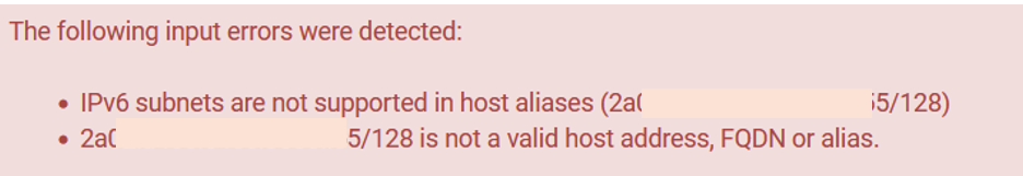

      I first tried to define a rule:
      Allow IP6-rangeA to some port
      => not possible
      Then I tried to define a (network) alias:
      SomeLans: 'IP6-range Lan-A' + 'Ip6-range LanB'
      => not possible
      Then I tried to do the same for a single IPV6 address
      => not possible
      Only 32 bit addresses supported

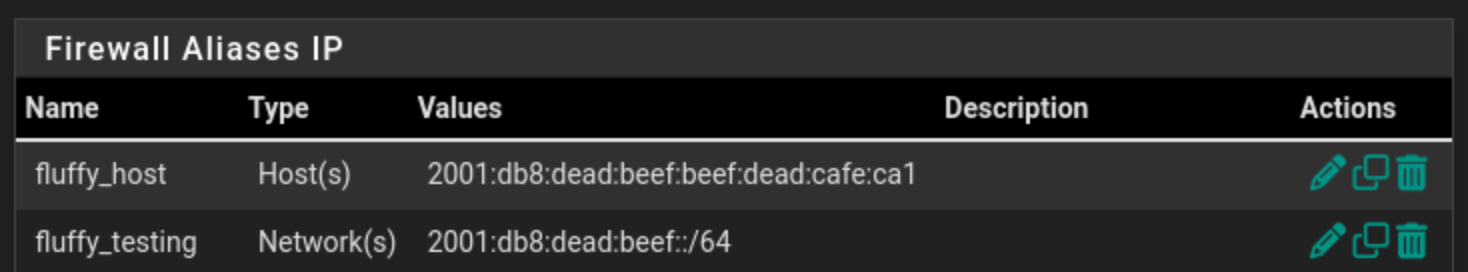

        @louis2 what pfSense version are you using? It works beautifully for me.
        You use type 'Host' for a host and of typoe 'Network' for a networks.
        But what you can't do is use an IPv6 address as type 'Host' with netmask 128. Just don't add a netmask and netmask is not necessary for hosts since the type 'Host' makes it clear that it expects a host.
        Addition: what is not possible, is to use type 'Host' to add multiple IPv6 host address in one step, like 2001:db8:dead:beaf::1-2001:db8:dead:beaf::9. That is indeed possible for IPv4 but not IPv6.

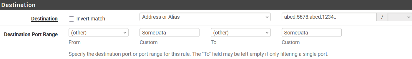

          You are right! It is possible via an alias! Do not know why it did not work. See screen shot. I was only allowed to select IPV4-ranges /32 max .....
          My confusion started there
          No idea why I had this trouble ! Note that I still can not enter an address where the text states 'alias or address'
          For info I am running the latest pfSense+ version
          • patient0P Online
            patient0 @louis2
            @louis2 said in Filter an IPV6-address not possible !!?? :(:
            Mmmh, if I set the 'Address Familty' to 'IPv6' it does work for me (but not if set to 'IPv4+IPv6')
