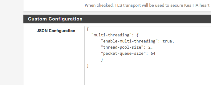

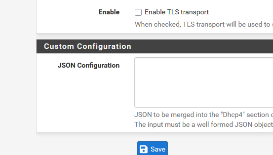

                          As you don't change a 'hard coded' GUI settings (I couldn't find any "multi-threading" settings in the GUI code, so no "multi-threading" in the kea-dhcp4.conf file neither) you have this possibility : you saw this on then Services > DHCP Server > Settings page :
                          Add your 'extra' settings there !
                          Like this :
                            "multi-threading": {
                                "enable-multi-threading": true,
                                "thread-pool-size": 2,
                                "packet-queue-size": 64
                          Save the settings - and Apply. Check that you did not receive any System notifications ! Check the DHCP server lof for a clean restart without error message from the DHCP4 process.
                          Now check your /usr/local/etc/kea/kea-dhcp4.conf, and check if your settings are there.
                          I found them at the end of the file.
                          Be aware : one space off, one little 'syntax error' and the DHCP config file checker refuses to accept your settings.

                            @Gertjan you must have answered at the same time as Ianswered. The problem was I had a malformed json. I missed the outer {}. It's working now. Thanks
